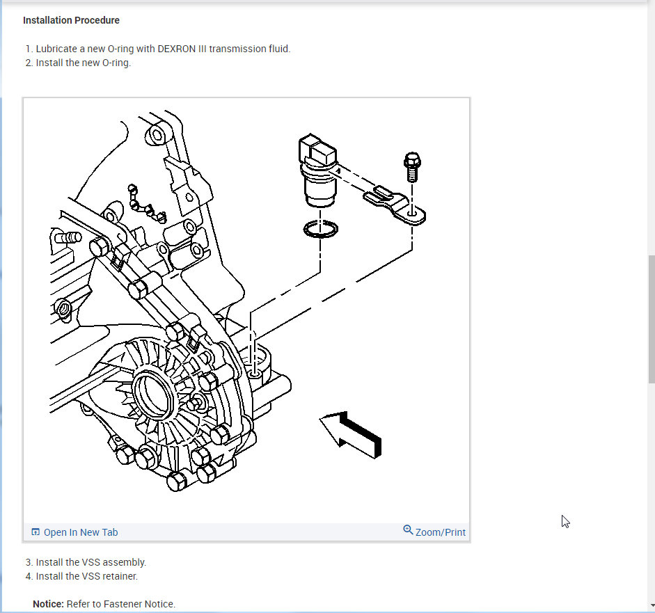

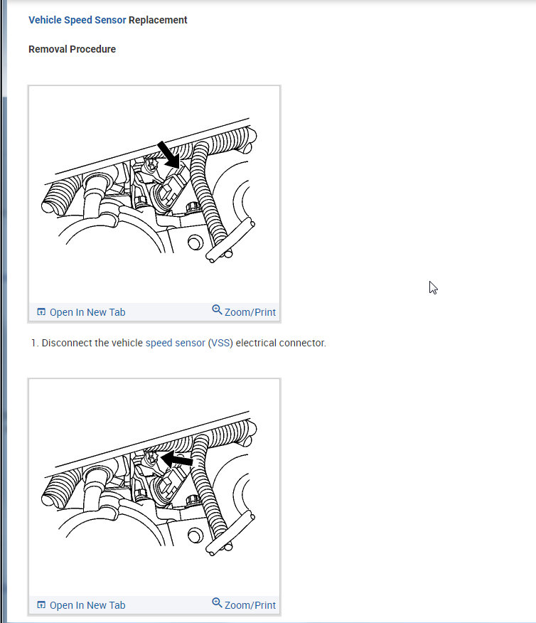

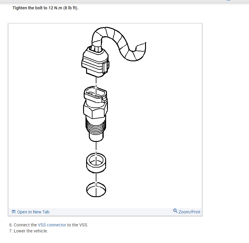

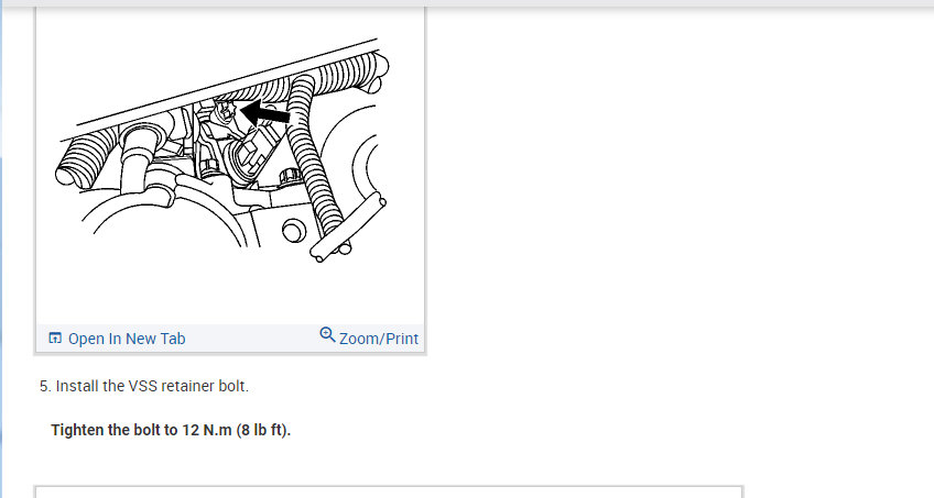

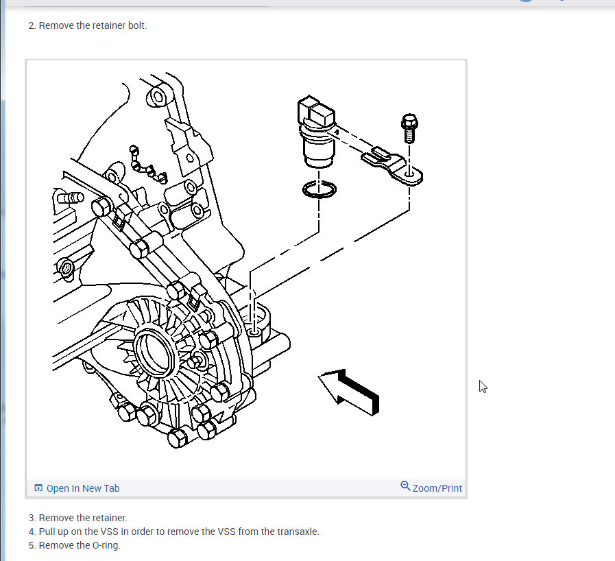

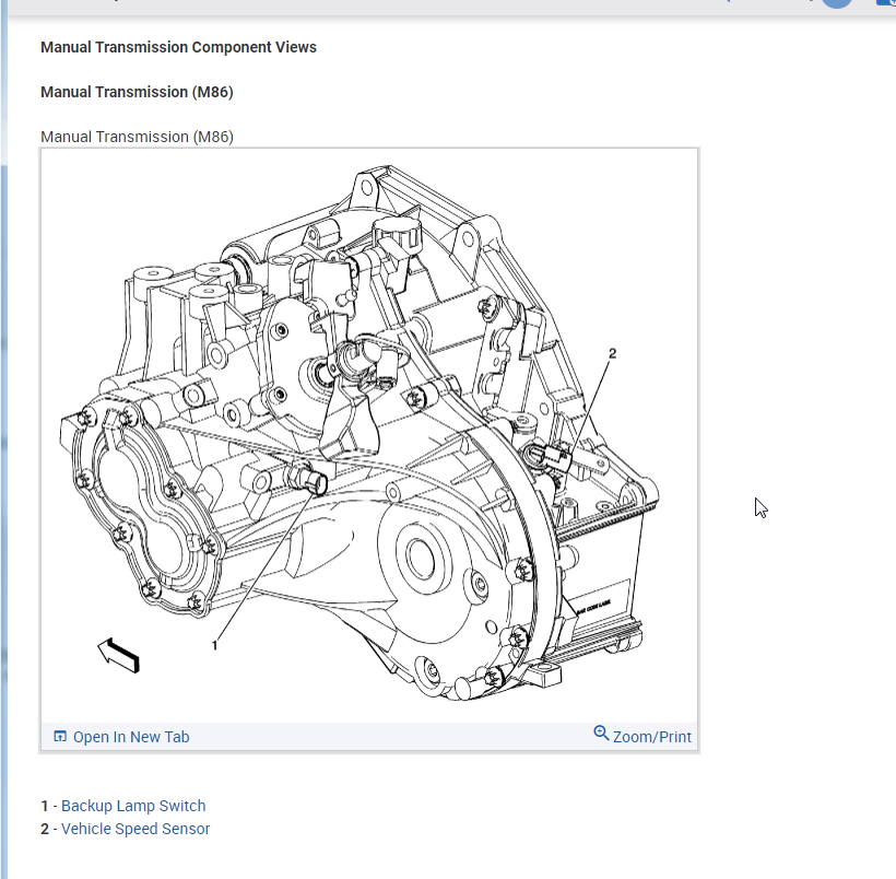

where would the speed sensor be for a manel transmission?
2007 CHEVROLET HHR
198,000 MILES • 2.4L • 4 CYL • 2WD • MANUAL
OMAR GARCIA VALLE
my speedometer doesn't work nor do the digital readings in the gauge cluster, like average speed, pox mileage, current fuel economy.

Sounds like you have a good idea on what the issue is as that is the most likely cause.
I attached the info for the vehicle speed sensor. Let us know if you need other info. Thanks
Nov 17, 2020 at 10:22 AM
OMAR GARCIA VALLE
Thank you so much. turned out the contour clip broke and popped out. got it all fixed now that you.
