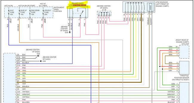

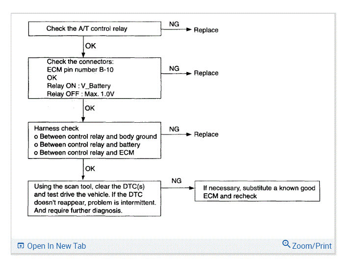

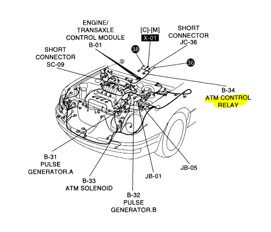

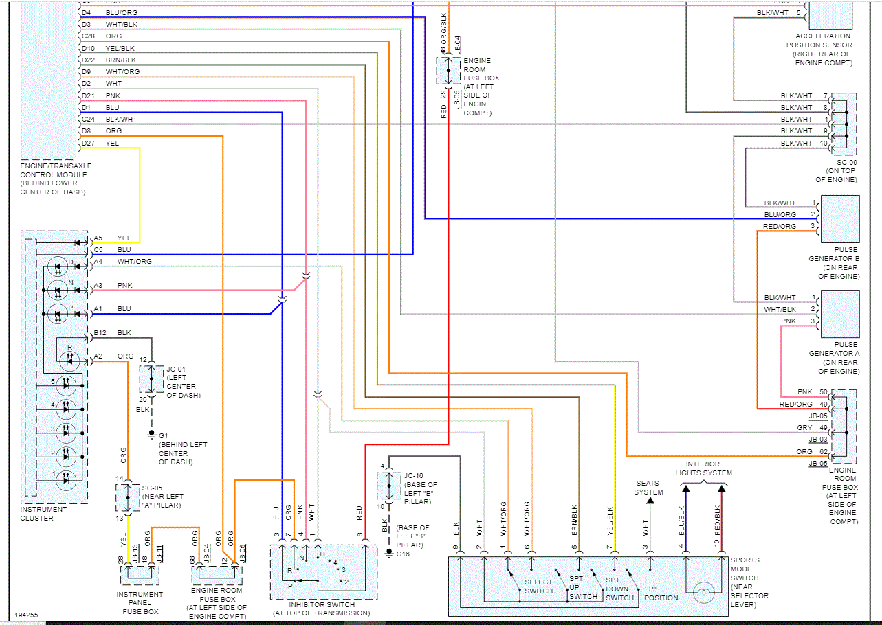

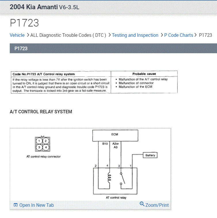

Code p1723, where is the automatic transmission control relay located?
2004 KIA AMANTI
175,000 MILES • 3.5L • 6 CYL • AUTOMATIC
MATT IN CHRIST
MEMBER
1 POST
FOLLOW
The code was p1723 and with the same symptoms or problem like features.
May 4, 2022 at 7:58 PM
CAR REPAIR CONTRIBUTOR
110,190 POSTS
The transmission control relay is under the dash approximately center. I attached the wiring schematic below and a pic showing the location. Additionally, the last two pics are the diagnostics for this specific code.
