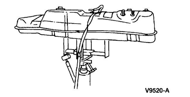

Has been unused for few years except a short trip to and back fifteen miles or so always done good on those trips. Started on a trip made it about fifteen miles and it started missing kind of like fuel filter made it to a place changed filter done okay about ten miles until I got on a pull acted like it would not take fuel changed filter again but did not help the more it run on a pull the worse it got. Stopped for awhile two hours waiting for help then started back home run good for about five miles and started same thing. Would run okay idling no miss but got bad on a pull I could barely mash fuel pedal or it would shut off. After awhile when it would start missing I would turn switch off and back on and it would go a couple miles okay not enough time for it to cool down. Although the engine was never overheated finely got it home just wondering where to start.

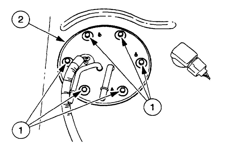

I would drop the fuel tank and have it flushed out and replace the filter as well. Fuel separates after sitting for long periods of time.
1. Disconnect the battery ground cable.
2. Perform fuel pressure release procedure.
3. Drain the fuel from the fuel tank.
4. Raise and support the vehicle.

6. Position the jack under the fuel tank.
imageZoom/Print
7. Remove the two nuts and the two fuel tank support straps.
NOTE: In this illustration, the vehicle body is shown removed for clarity.
imageZoom/Print
8. Partially lower the fuel tank.
imageZoom/Print

10. Disconnect the fuel lines from the fuel pump.
imageZoom/Print
11. Disconnect the fuel pump electrical connector.
imageZoom/Print
