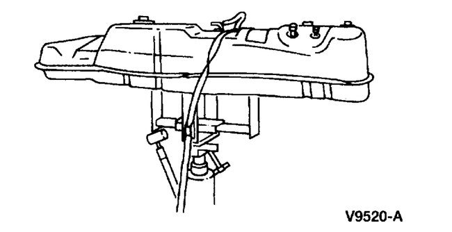

6. Position the jack under the fuel tank.
imageZoom/Print
7. Remove the two nuts and the two fuel tank support straps.
NOTE: In this illustration, the vehicle body is shown removed for clarity.
imageZoom/Print
8. Partially lower the fuel tank.
imageZoom/Print

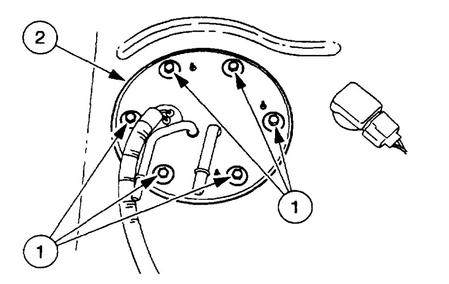

10. Disconnect the fuel lines from the fuel pump.
imageZoom/Print
11. Disconnect the fuel pump electrical connector.
imageZoom/Print

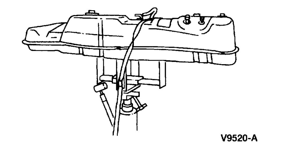

12. Lower the fuel tank.
imageZoom/Print
