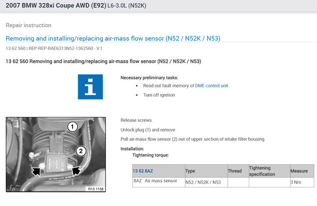

I am having issues with this car over and over again. I just today replaced spark plugs. When code read it says I need to replace the mass air flow Intake sensor. Where is a legit place for a good price to get the part?

Here are the instructions on how to replace the MAF sensor in the diagrams below. Check out the diagrams (below). Please let us know what happens.
