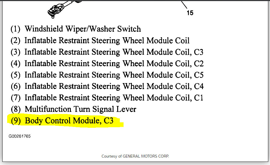

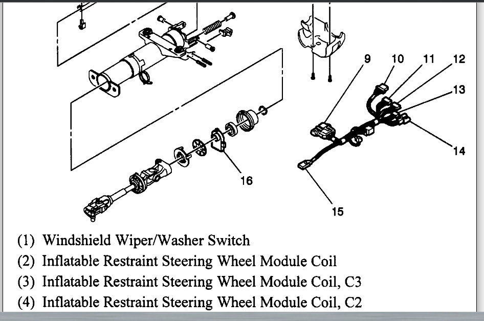

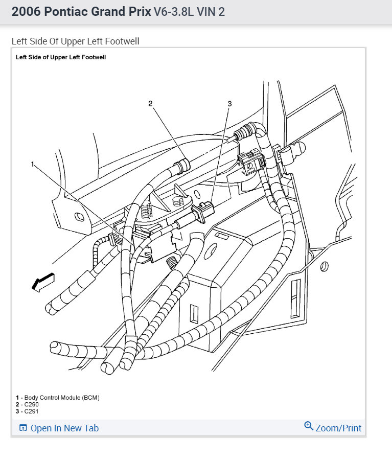

left turn signal light bulb comes on but wont flash, left emergency flasher light wont flash, left turn signal switch inside car light flashes fast. replaced bulbs and fuse but lights on left side still wont flash. i think it is the turn signal relay, but i can't locate it or find a diagram of it on line. I don't know where it is located at to replace relay.
Apr 28, 2019 at 9:45 AM
SCGRANTURISMO
  • 4,897 POSTS

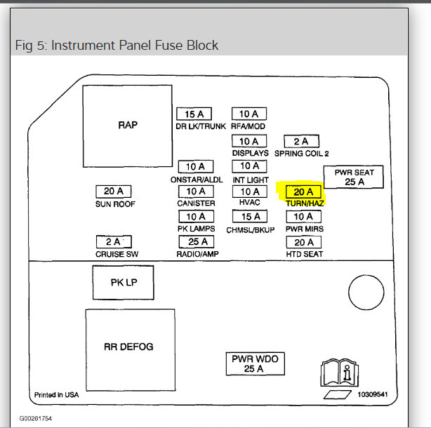

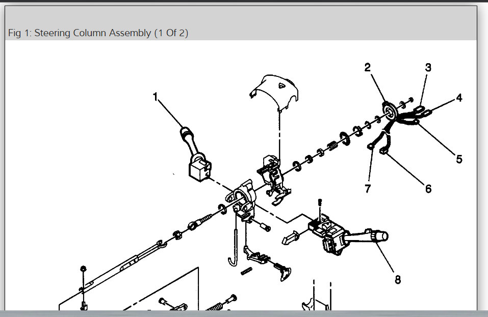

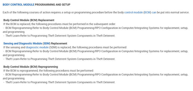

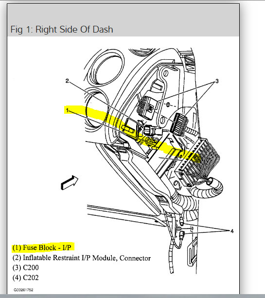

This could be a problem with your Body Control Module (BCM), which is located by the steering wheel column. It controls many functions, but the hazard/turn signal operation is one of them. It accomplishes this by supplying battery voltage to the bulbs at regular intervals when the flasher or turn signal switch is applied. In the diagrams down below I have included diagrams and descriptions for the BCM, Instrument Panel Fuse Block (which includes the flasher relay), and the Turn Signal/Flasher operation, as well as a complete set of the exterior lighting descriptions. Please get back to us with what you are able to find out. Check out the diagrams (Below). Please let us know what you find. We are interested to see what it is.

I can't find where the flasher relay is located to replace it.

Good evening,
There is no flasher for this as in the older cars. The newer cars, the flasher is the body control module.
This guide can help
https://www.2carpros.com/articles/turn-signals-not-working-blinker
The turn signal flasher function is performed by the Body Control Module (BCM).
