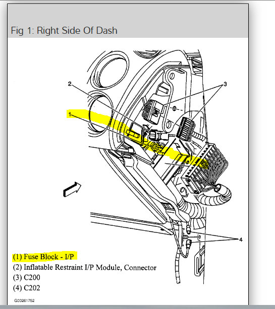

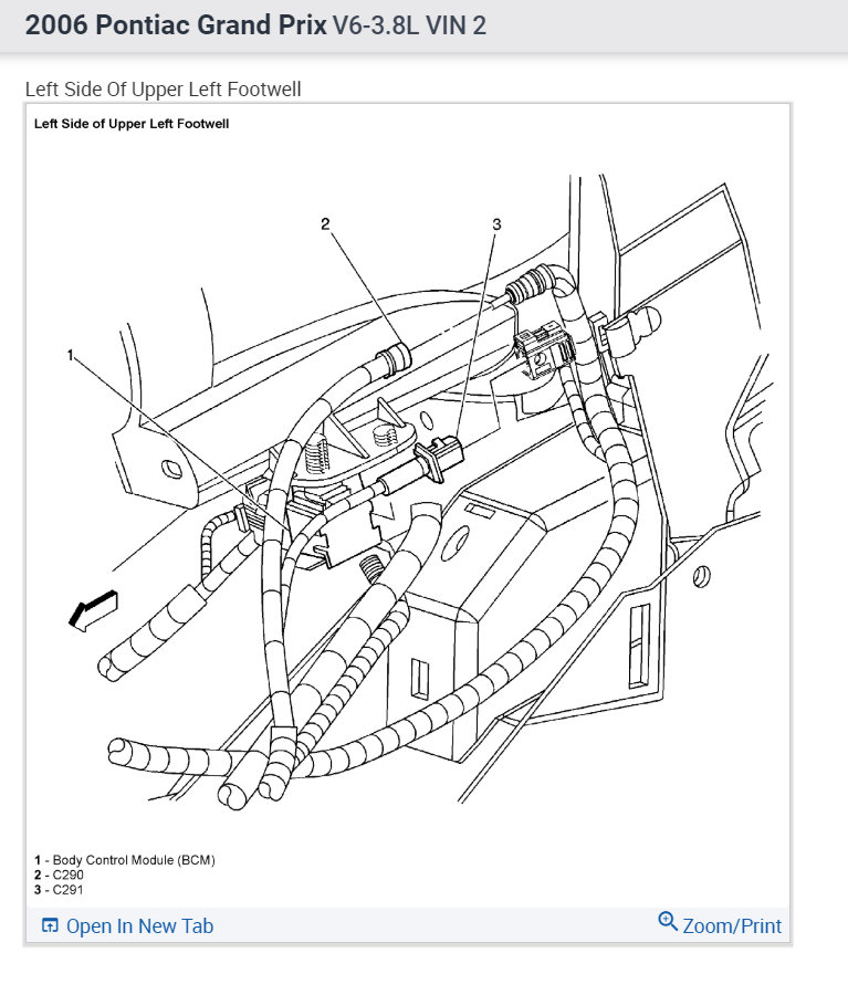

left turn signal light bulb comes on but wont flash, left emergency flasher light wont flash, left turn signal switch inside car light flashes fast. replaced bulbs and fuse but lights on left side still wont flash. i think it is the turn signal relay, but i can't locate it or find a diagram of it on line. I don't know where it is located at to replace relay.

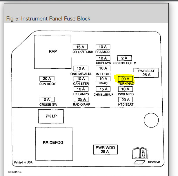

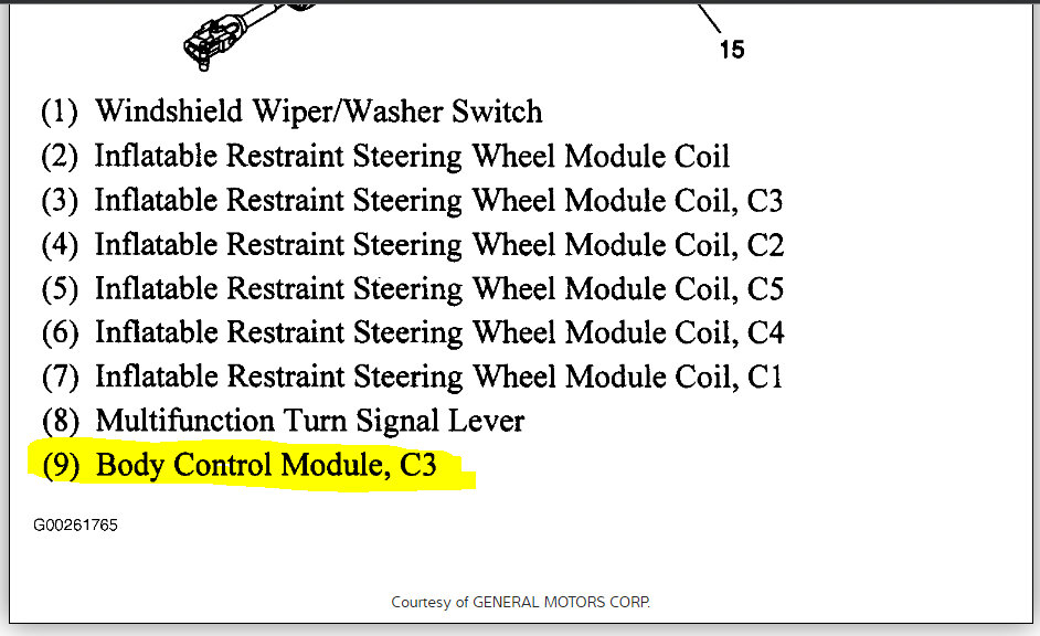

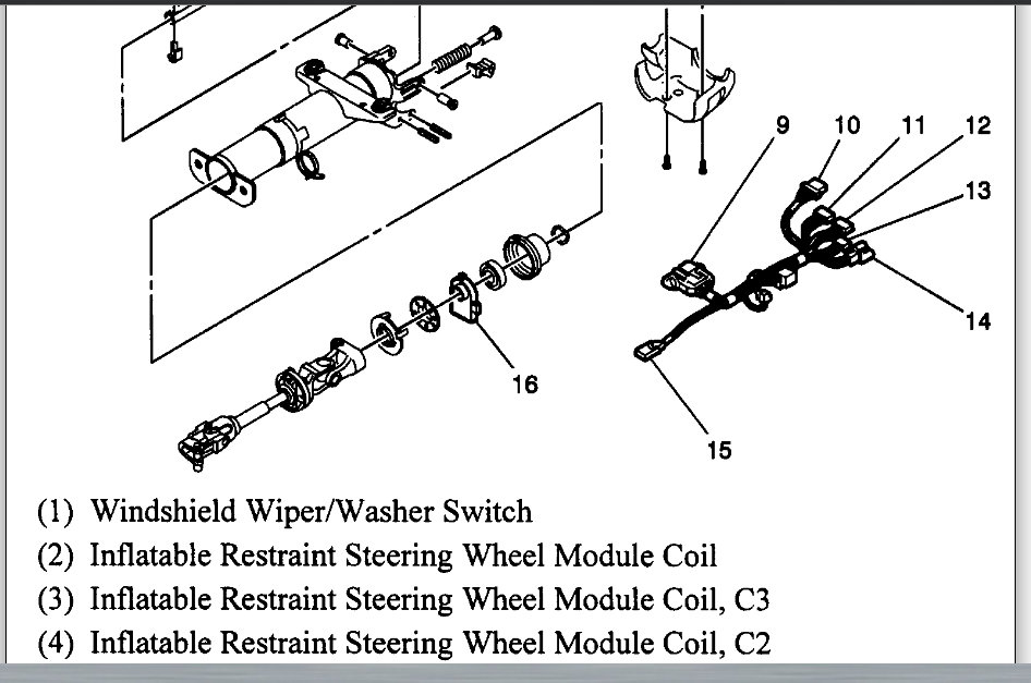

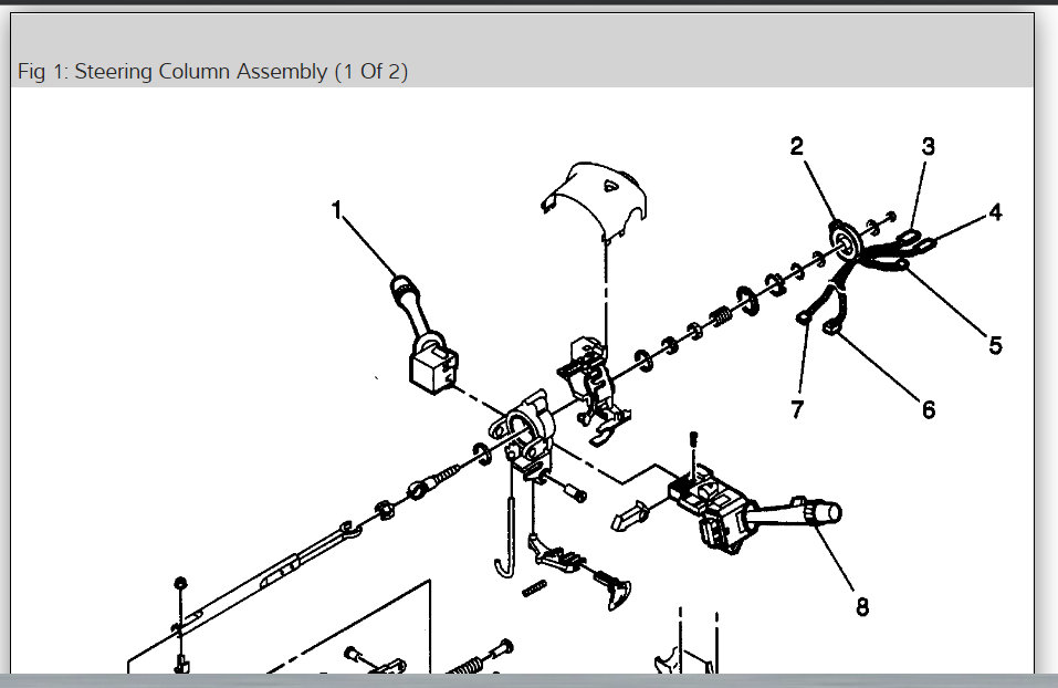

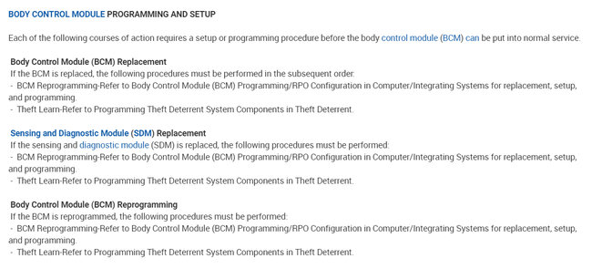

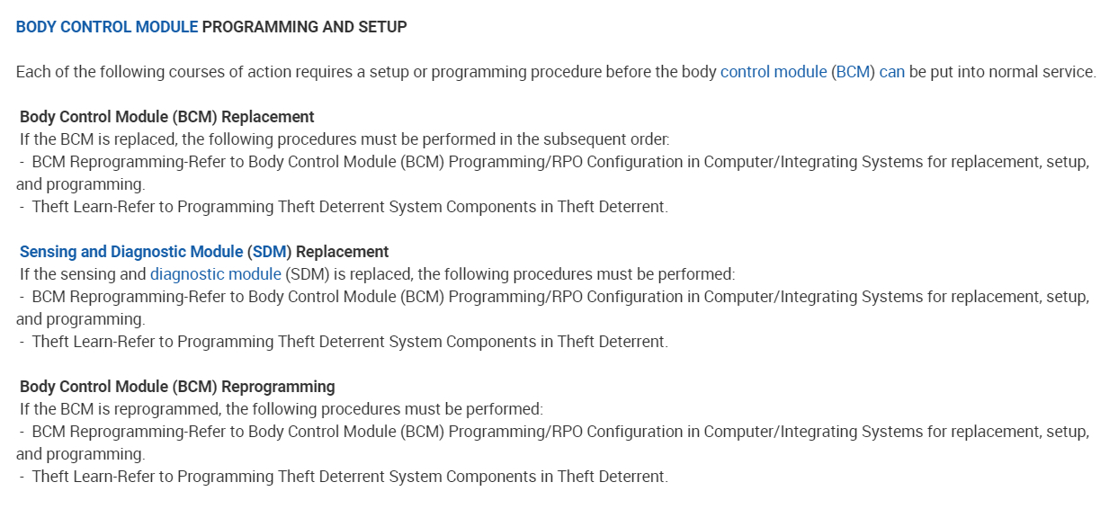

This could be a problem with your Body Control Module (BCM), which is located by the steering wheel column. It controls many functions, but the hazard/turn signal operation is one of them. It accomplishes this by supplying battery voltage to the bulbs at regular intervals when the flasher or turn signal switch is applied. In the diagrams down below I have included diagrams and descriptions for the BCM, Instrument Panel Fuse Block (which includes the flasher relay), and the Turn Signal/Flasher operation, as well as a complete set of the exterior lighting descriptions. Please get back to us with what you are able to find out. Check out the diagrams (Below). Please let us know what you find. We are interested to see what it is.

Good evening,
There is no flasher for this as in the older cars. The newer cars, the flasher is the body control module.
This guide can help
https://www.2carpros.com/articles/turn-signals-not-working-blinker
The turn signal flasher function is performed by the Body Control Module (BCM).

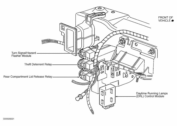

i having a problem finding the location for turn signal flashers on 2003 pontiac grand prix

Left side dash. Here is a the diagram below so you can see how the job is done. Check out the diagrams (Below). Please let us know if you need anything else to get the problem fixed.

The turn signals and hazards stopped working on my grand prix, so i checked the fuses and they were blown. i've replaced the fuses but it seems to only fix the problem for a short time before the fuses blow again, they dont blow at the same time the hazards only blow when i use them. I've checeked all the bulb's and for any loose wires maybe shorting out to ground but havent seen anything wrong yet. Shortly after this problem started my brake light stopped working, except for the middle one. all the bulbs are fine and no fuses are blown. i dont know if these two problem are related. I also have a remote starter on my car could that be causing the problem?
