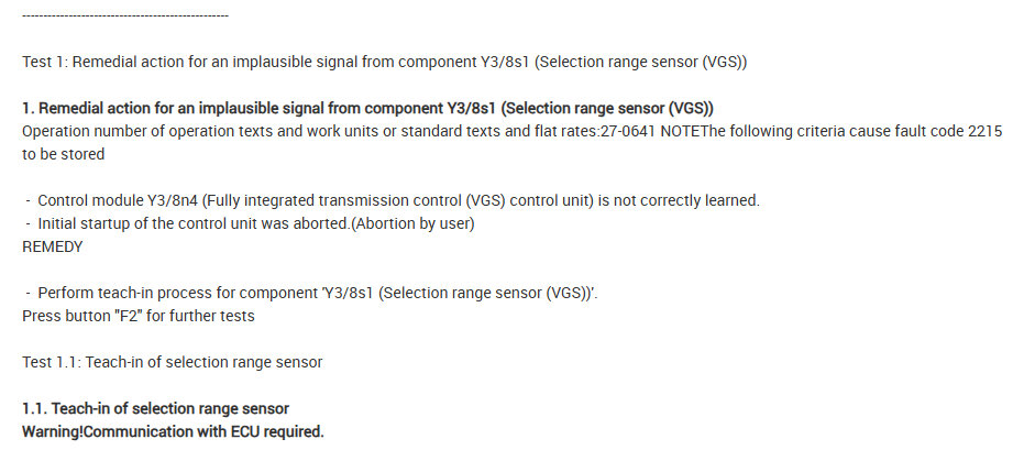

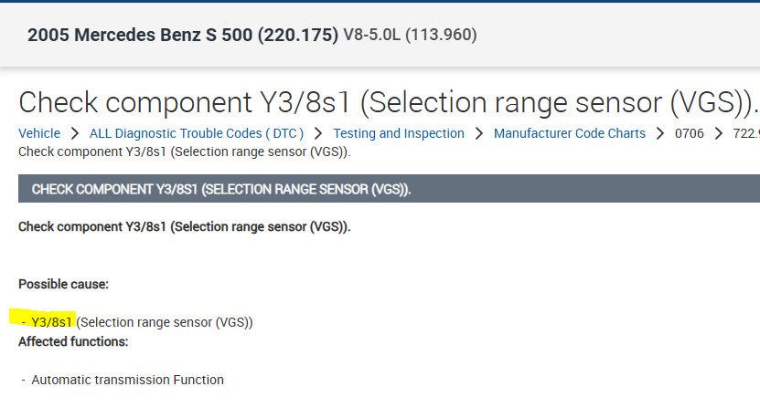

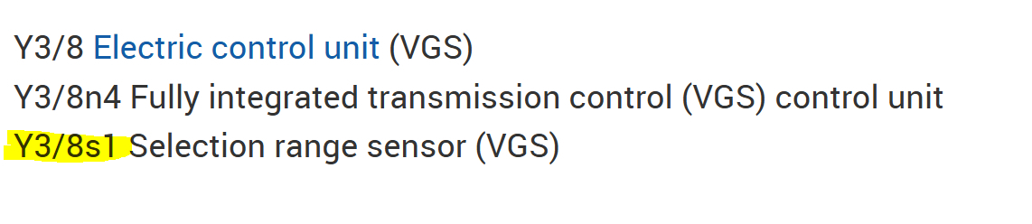

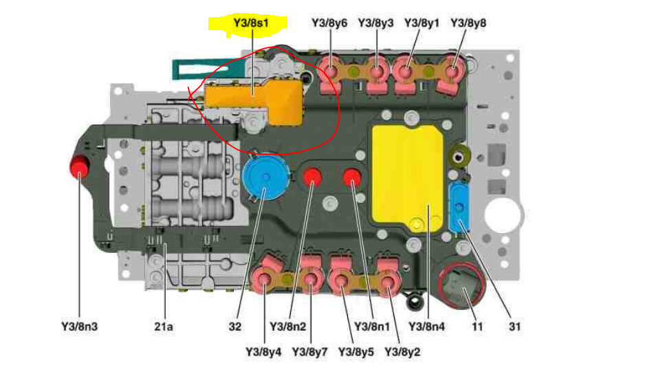

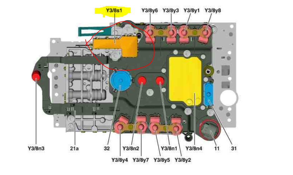

The transmission range sensor is on the valve body (inside the transmission). You can access it by removing the transmission oil pan.
See pics 1and 2 below. The remaining pictures are diagnostics (vague).
Let me know if this helps.
