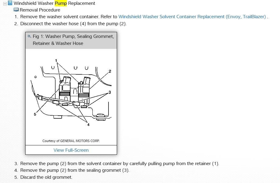

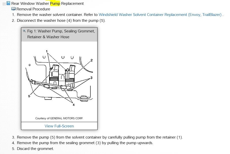

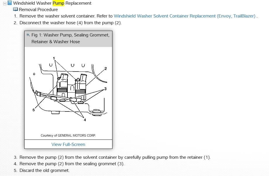

Windshield washer pump front and rear location does not work need to replace.
Dec 4, 2018 at 6:43 AM
PATENTED_REPAIR_PRO
  • 1,853 POSTS
The rear pump appears to be attached to the washer container, so that will have to be removed. Same for the front.
THis video can help
https://youtu.be/ezjJz_N5cFQ
Check out the diagrams (Below). Please run this test and get back to us.
