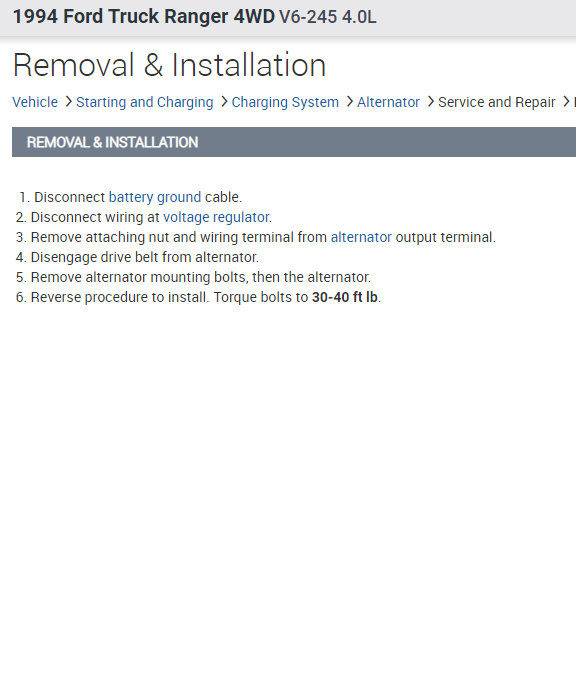

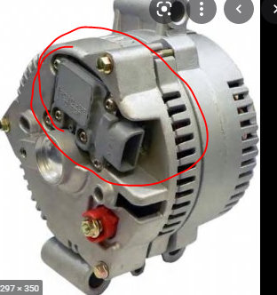

The voltage regulator is a part of the alternator.
It the part where the wire hooks to the alternator.
https://www.2carpros.com/articles/how-to-replace-an-alternator
