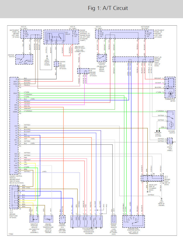

So I am having trouble locating the vehicle speed sensor A. It is not in the same spot at the 2003 model. Thanks appreciate the help in advanced.

I currently do not have the vehicle with me, do a2 and u3 have it in different locations? I checked behind the engine driver side where the 2003 has it but this 2004 does not have it there. Looked on all data and Mitchell and it tells me that same spot but there is no sensor there!

Alldata asks for for the transmission type. that is what I am using let me check.

Is this a 1ZZ or 2ZZ motor?

Should be a 1zz

I cannot find any diagrams on the sensor location which is strange but I did find the wiring diagrams which show the color wires going to it and the description of where it is. On top of the tans axle.
