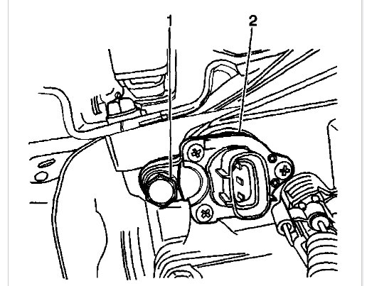

I need to replace the vehicle speed sensor, and I can’t find where it is on the transmission.

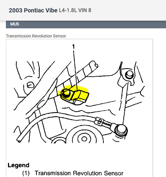

It's been a while since I've seen one of these. Two different transmissions were also used, MU4 and MU5.
I attached the best pictures I could find below. Note: If you follow the negative battery cable to where it mounts on the transmission, it should be very close to that area.
Take a look at the pics and let me know if they help.

Yes. I found it.
