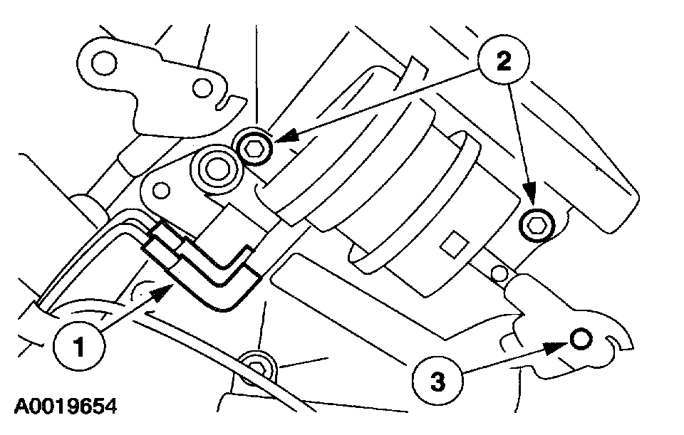

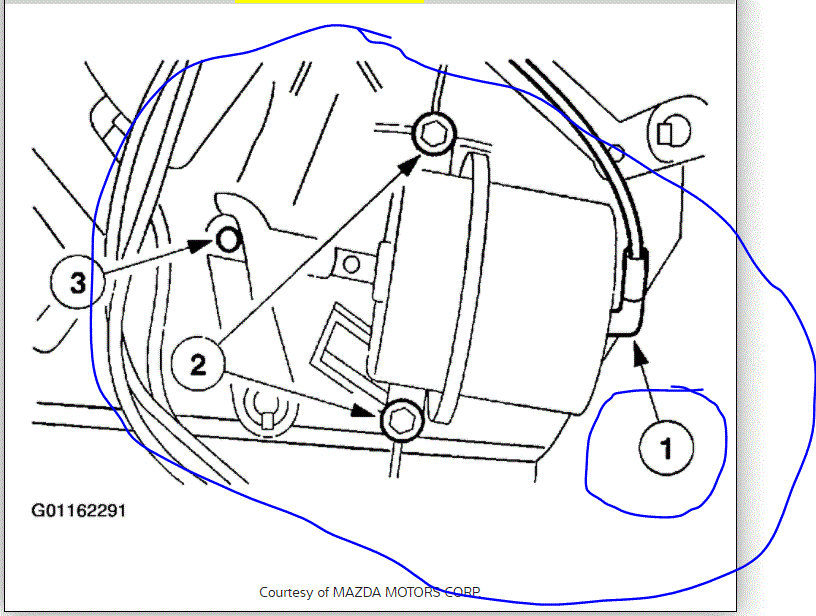

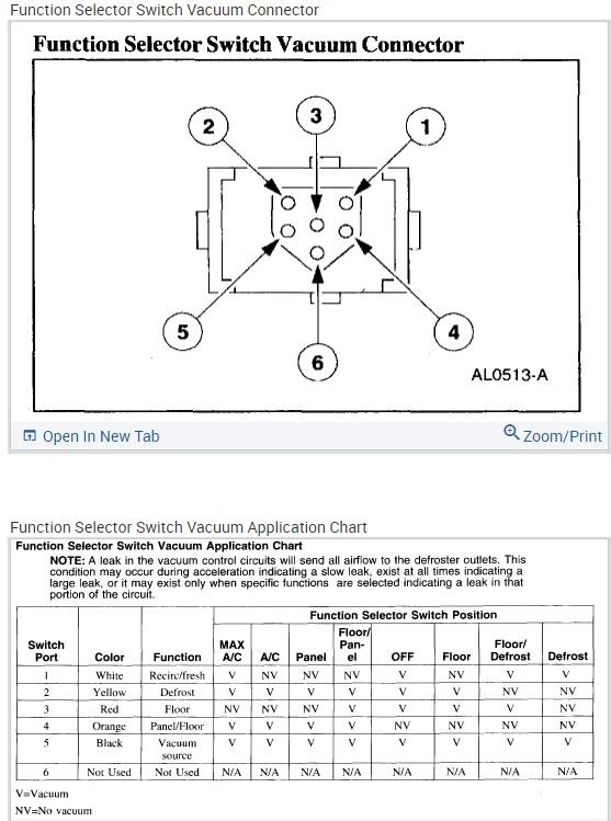

The airflow direction actuators (mode doors) are vacuum actuated. I was only able to find one pic from the manual which I attached below.
I circled the vacuum hose (number 1) in the pic.
Before you replace it, make sure there are no vacuum leaks which can cause the system to default to defrost. There should be a vacuum supply from the intake manifold of the vehicle which will route through the firewall into the controller.
If you can't locate it, disconnect the mode actuator vacuum, request air flow to change to the floor and see if there is vacuum to it. If there isn't, there is a leak before that point and the actuator is likely okay. If there is vacuum and it doesn't respond, the actuator is likely bad.

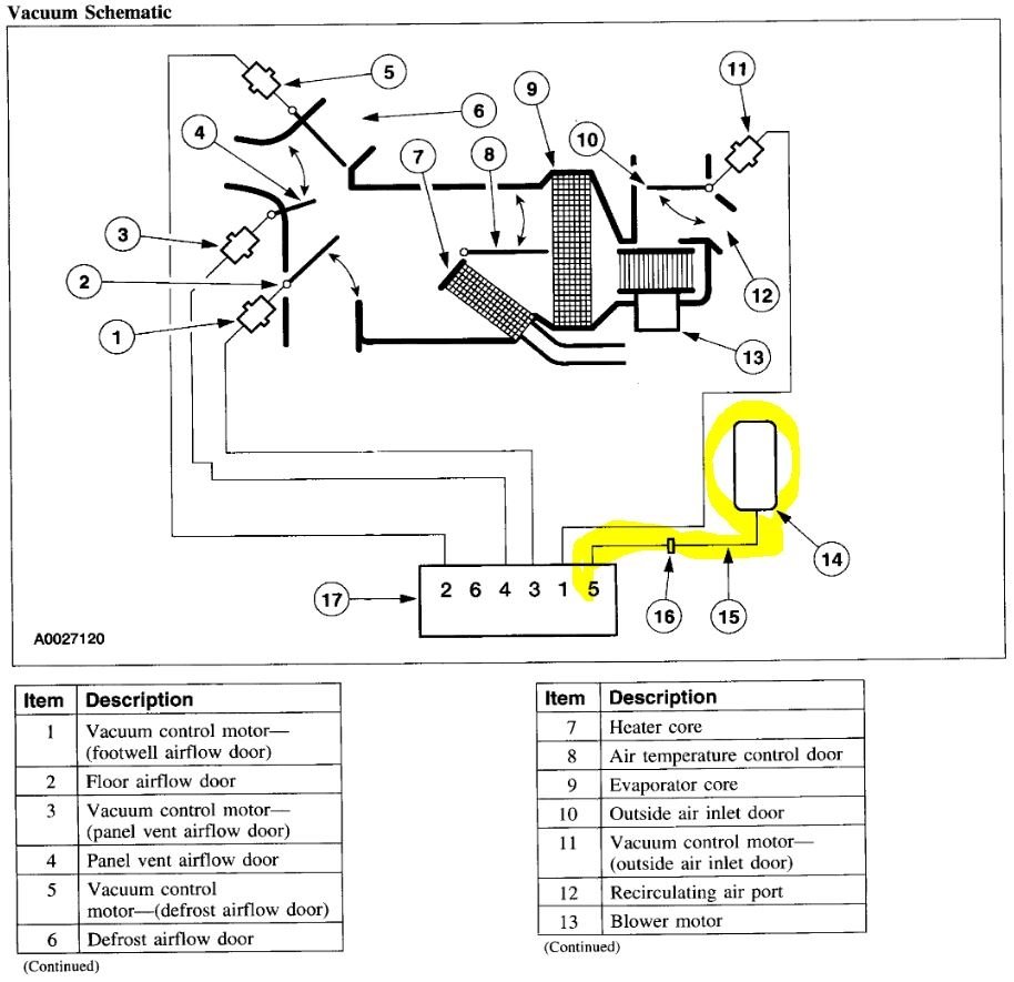

If it will blow air and you can control the temperature but cannot get it to select the floor or dash that is the function/mode door actuator, not the blend door. Blend door controls temperature, function doors control air direction. Now in this case there are actually 4 different vacuum motors that control where the air goes. As the image says the default for them if the system loses vacuum is to switch to defrost and stay there. So I doubt the issue is the actuators but instead a vacuum leak that is causing the controls not to work. The main vacuum line for the controls comes off of the engine and over to the vacuum reservoir, then through a black line to a check valve and then through the firewall and to the back of the control head. It is a common thing for the lines to crack or the fittings to rot off and then the system stops working as it should. I would start at the intake manifold and check the vacuum lines from there to the vacuum canister. Then from it to the firewall. A quick test that might help you is to start the engine and shut off everything around you, then listen right next to the control head for a hiss indicating a vacuum leak. If you don't hear anything you can use a can of carb cleaner to spray a short burst towards the various vacuum lines and connectors under the hood wit the engine running. A sudden change in the engines rpm means you have a vacuum leak in that area. I suspect you will find the issue under the hood, if not then you will need to remove the heater control head to get to the back of it to test for vacuum there. For that you remove the center dash trim then the 4 screws that hold the control head in place. Once it is free locate the black vacuum line, it should have a good vacuum on it with the engine running at an idle.

Almost has to be a leak, if it was one of the vacuum motors you would only lose that function, so you might have the floor vents, dash and outside air, or dash defrost and vent. But to lose everything and have only defrost it has to be a loss of vacuum. Inside the vacuum motors is just a diaphragm and a couple springs. Apply vacuum to one side and it moves that way, apply it to the other and it moves that way, or in this case with the loss of vacuum the defrost opens because the springs in the units move them to that position as the failure mode, that lets you still drive the vehicle and still get some heat but tells you that something is wrong. I actually like the vacuum systems better than the electronics as they are generally a lot easier to diagnose. You pull the control head and use a vacuum pump to test the actuator and listen for the hiss of a leak. The only drawback is that it can become a mess of spaghetti if you have one of the fancy dual control systems.

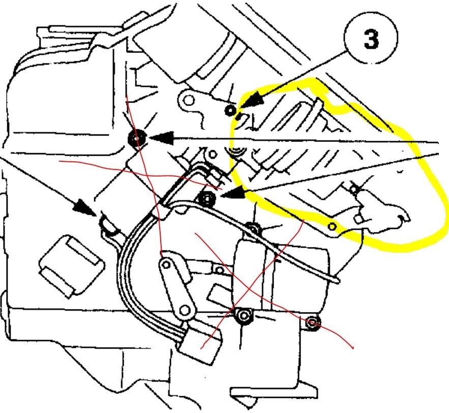

It is under the dash attached to the heater core case. There will be three of them in the same area. One opens the dash vents, one the floor and one the defrost. The one you want is the farthest back toward the seats on top. Circled in the image.

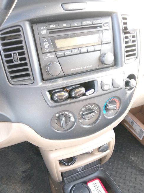

Any chance you could tell me which part of the center console I have to remove? I'm really hoping the vacuum can be found behind the bottom brown one....
Nov 6, 2020 at 8:19 AM
  • 110,248 POSTS
If you are referring to the actuator, it is basically behind the glove box and to the left. It will be mounted on the HVAC box. Is that what you are referring to?

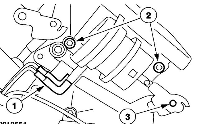

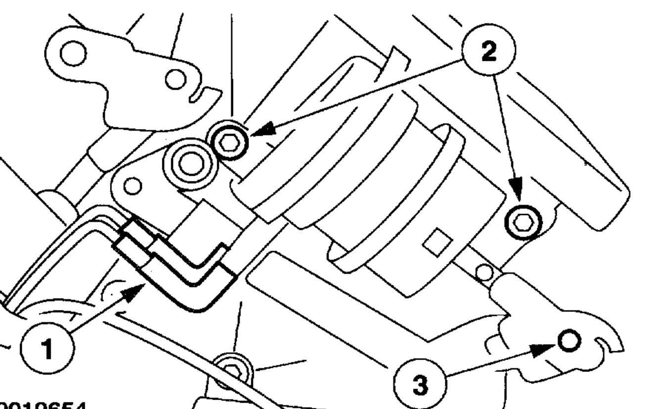

For some reason, I don't have it listed under a Mazda. However, here are the directions for a Ford Escape, which I believe is basically the same vehicle. I hope it helps.
___________________________________
2002 Ford Truck Escape 2WD V6-182 3.0L VIN 1 SFI
Panel Vent Vacuum Control Motor
Vehicle Heating and Air Conditioning Air Door Actuator / Motor Service and Repair Procedures Panel Vent Vacuum Control Motor
PANEL VENT VACUUM CONTROL MOTOR
REMOVAL
pic 1
1. Remove the vacuum control motor.
1 Disconnect the vacuum line.
2 Remove the two screws.
3 Disconnect the vacuum control motor from the door lever.
INSTALLATION
1. To install, reverse the removal procedure.
I hope this helps.
Nov 7, 2020 at 11:26 AM

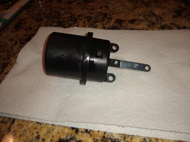

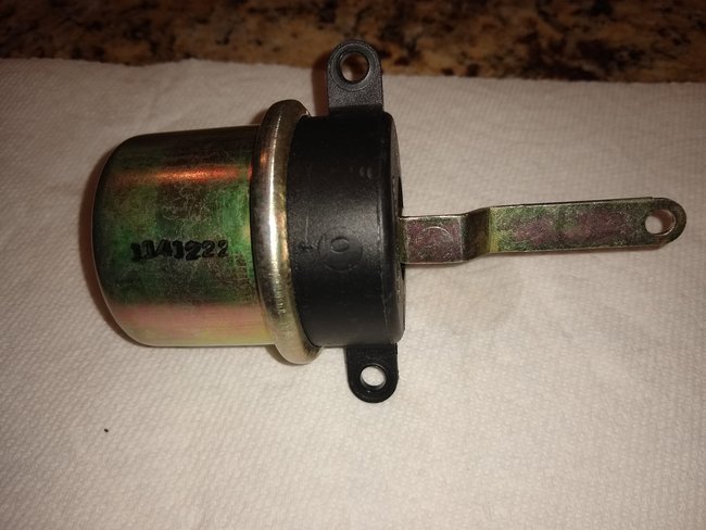

Thank you. I did try to replace it yesterday, but part I had ordered from Rock Auto didn't fit. It was listed as being for my car (but was the Ford Motorcraft version), but the mounting holes weren't in the same place as the part on my car, and the pin that attaches the vacuum line was too small; hose was way too loose. I'm having trouble finding the part.. no one seems to carry it. I guess I'm going to have to go to the dealer....

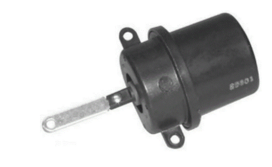

What part number did you find? The idea they sent the wrong part is a concern. I tried to look up a part number but nothing was available.
Let me know if you have the part number, send it to me. I'll try to help.
Take a look at the attached pic and let me know if that looks like the correct part. If it does, here is where I found it.

The first picture below is the Motorcraft part I received from Rock Auto. The second picture is the part I removed from my car. You can see the problem.
Nov 8, 2020 at 8:50 PM
STEVE W.
  • 15,409 POSTS
If you apply a vacuum to the hose port does your old part move or does air just flow through it? Just want to verify the problem before you get lost trying to hunt down the part.
The one they sent you looks like the one for the defrost and floor vents. In looking at the parts book I don't see the other one listed but Ford or Mazda should be able to get it, the Escape is virtually the same vehicle with the same HVAC system.
