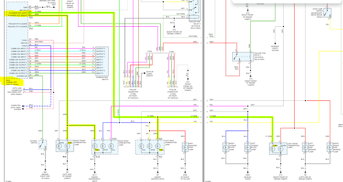

Where is the turn signal relay located at?
2006 NISSAN PATHFINDER
166,660 MILES • 4.0L • V6 • 2WD • AUTOMATIC
ONPUBLICTY
I don't know where the turn signal relay is located at.
Nov 27, 2024 at 4:35 PM
  • 110,194 POSTS

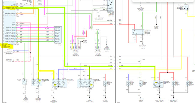

Looking at the schematic, this vehicle has signal relays for trailer towing. However, the vehicle signals are controlled by the body control module.
I attached a picture below showing what I mean. Let me know if that helps answer your question. Also, let me know what is happening.
Take care and Happy Thanksgiving.
See pic below.
