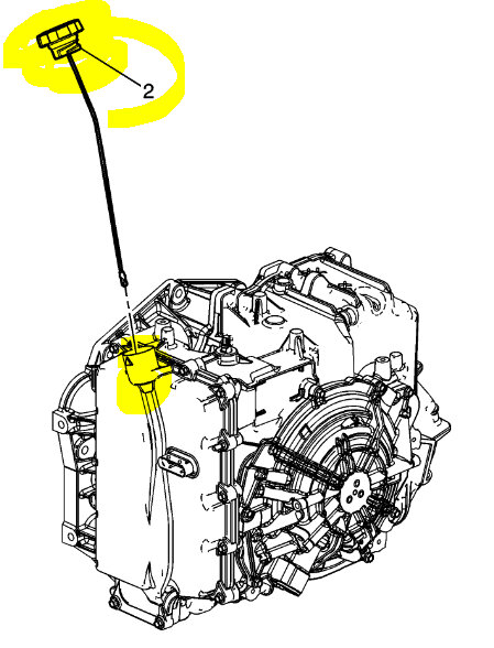

Looking to check the transmission fluid on my vehicle. Can’t find a dipstick.

If you open the hood, locate where the engine and transmission meet. On the side of the transmission with the transmission pan is where you will find the dipstick. I attached a picture below to help.
Let me know if you find it. It is down low and has a screw cap rather than a traditional dipstick.
See pic below.

Thanks Joe, I did find it. Boy do I feel dumb! It was out of sight Simply because of a hose. I should have seen it though. Can you tell me the correct procedure for checking it? Thanks in advance.

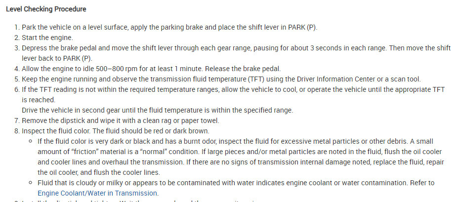

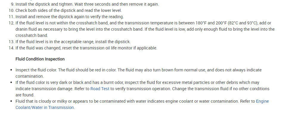

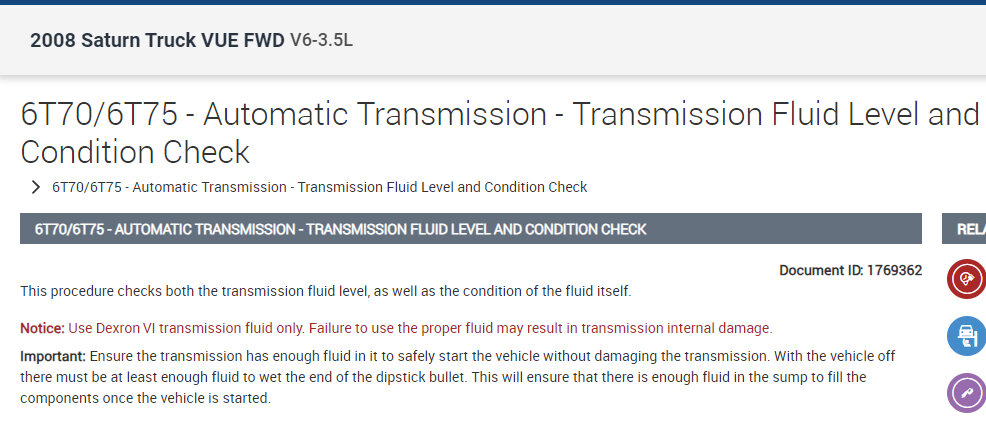

As far as checking, I attached the directions below which also include inspecting the fluid condition. Take a look through them and let me know if you have questions.
