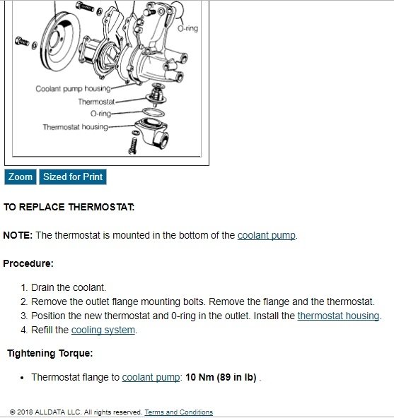

I want to replace the thermostat because I believe it is busted. The garage cannot see me until Monday, so I would like to try fixing it on my own if possible. Where is the thermostat located and how can I replace it?
Jan 5, 2018 at 5:42 AM
CJ MEDEVAC
  • 11,000 POSTS
This work for you?
The Medic
Jan 5, 2018 at 10:39 AM
JMTHOMASIAN
Yes, this is great! Thank you!
