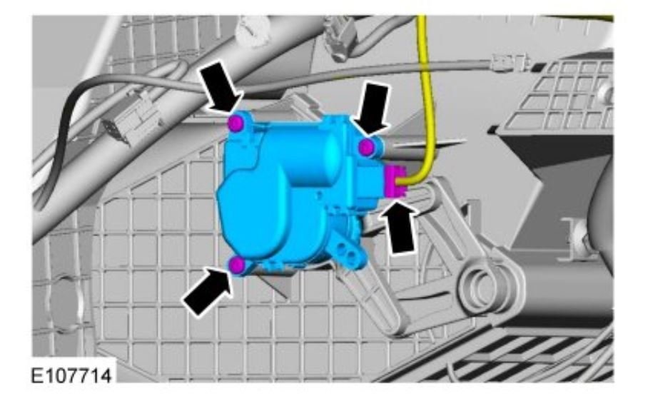

I have found the air mix blend door actuator and the blower position blend door actuator, but I need the temperature mix blend door actuator.

Good afternoon,
The full dash has to be removed to gain access to the actuator. It is on the side of the heater case.
Temperature Door Actuator
Removal
NOTE: Removal steps in this procedure may contain installation details.
1. Refer to: Heater Core and Evaporator Core Housing - Vehicles With: Electronic Manual Temperature Control (EMTC) See: Housing Assembly HVAC > Removal and Replacement > Heater Core and Evaporator Core Housing (412-00 Climate Control System - General Information, Removal and Installation).
