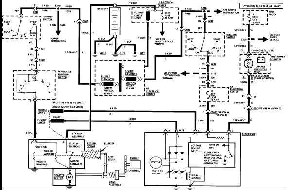

Anybody know where the starter relay is in this car?

Hi and thanks for using 2CarPros.com. Your vehicle does not have a traditional type starter relay. The solenoid switch on a cranking motor closes the circuit between the battery and the starter. The attached schematic shows power from the ignition switch goes directly through the neutral safety switch and then to the starter solenoid.
Take a look at the schematic and you will see what I mean.

I see what you mean where it follows the path from the ignition switch to the netrual switch and to the starter solenoid and completes the circuit. So it’s best to just replace the entire starter if the solenoid goes. I wanted to get mine rebuilt so just wanted to know if it had a relay. What year did they come out with them? I read on modern cars, to check the relay first before looking at the starter.

I see what you mean where it follows the path from the ignition switch to the neutral switch and to the starter solenoid. So it is best to just replace the entire starter if the solenoid goes. I wanted to get mine rebuilt so just wanted to know if it had a relay. What year did they come out with them? I read on modern cars, to check the relay first before looking at the starter.

Honestly, relays have been used for a long time, but not on all vehicles. I hope everything works out for you. And yes, it is not worth rebuilding the starter with what a new one cost. Let me know how it turns out.
