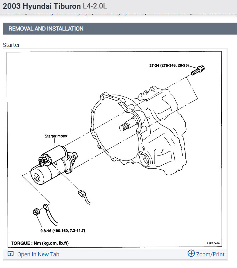

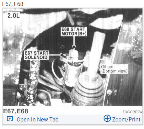

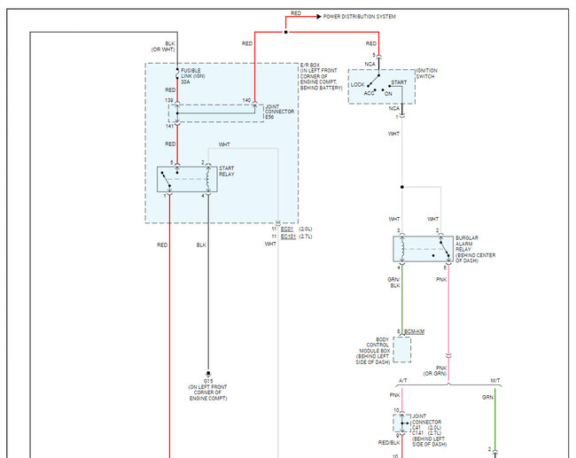

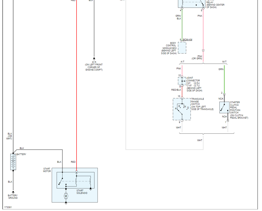

Intermittent no start. changed clutch safety switch. need to test starter and cables?
Dec 10, 2023 at 1:22 PM
Experienced Mechanic
55,746 POSTS

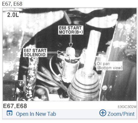

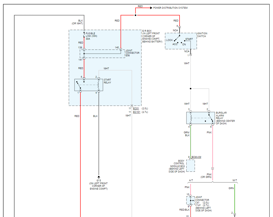

Good call, here is the location of the starter motor and the starter wiring diagrams so you can see how the system works which can help.
Here is a guide that can help as well:
Check out the images (below). Let us know how it goes.
