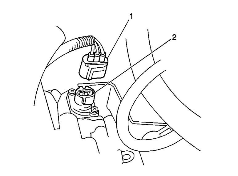

Where is the speed sensor that controls the speedometer and odometer?
Dec 29, 2018 at 4:55 AM
Good afternoon,
The sensor is on the output housing by the right front axle where it exits the trans-axle.
I attached a picture for you to view.
Make sure the connector is clean and tight.

The vehicle speed sensor (VSS) is mounted on the trans-axle. As the trans-axle turns the VSS, the VSS provides the speedometer with a vehicle speed input through voltage pulses. Each revolution of the axle shaft equals 4 pulses. This input is used to drive the speedometer.

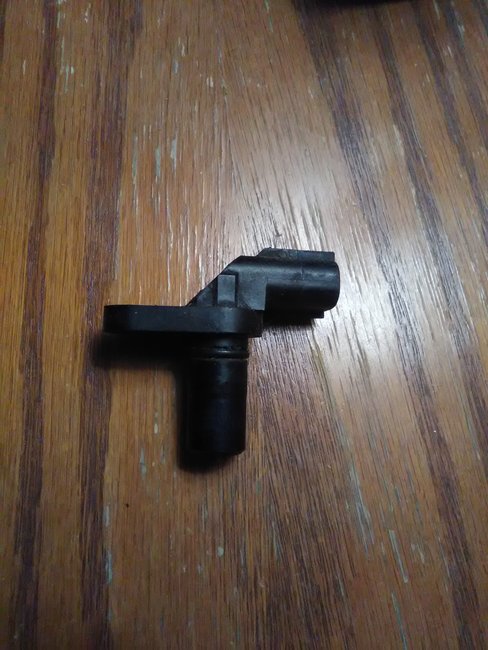

I found one speed sensor, but can't find the other one. The one I found was on top of the transmission. Where is the one located that you sent me a picture of( the one with the three wires)? Is it on the driver or the passengers side?
Dec 30, 2018 at 5:41 AM

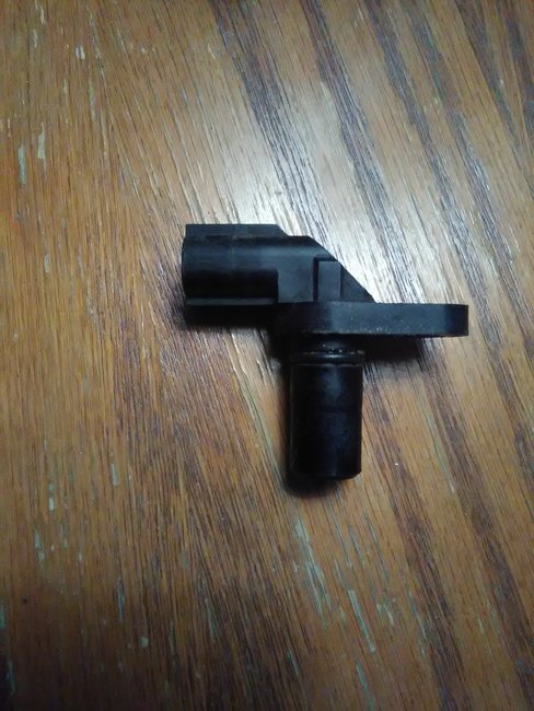

TINABOYER
This is the picture of the speed sensor I replaced. The hubs do have ABS.
Dec 30, 2018 at 5:49 AM
They are transmission speed sensors, not the vehicle speed sensor.
it is under the car, passenger side where the right axle goes into the transmission.
