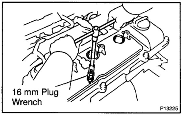

How to remove spark plugs?
Aug 1, 2017 at 10:38 AM
Experienced Mechanic
55,588 POSTS
Here is a guide hat will help you get the job done:
https://www.2carpros.com/articles/how-to-change-spark-plugs
DENSO SK20R11
NGK IFR6A11
Torque 18 Nm (13 lb-ft).
Image (Click to enlarge)
