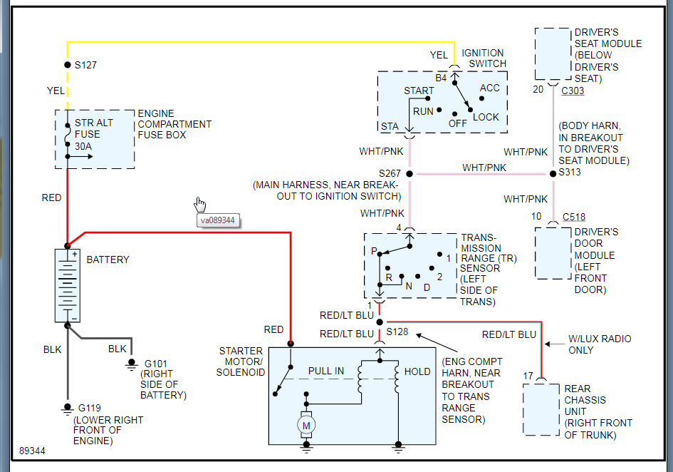

Where is the solenoid located? Not the one on the starter itself
1997 FORD CROWN VICTORIA
300,000 MILES • 4.6L • 6 CYL • 2WD • AUTOMATIC
INICE
Needing to find this small part and can't seem to find it. I looked online and there was no actual answer. Please help!!
Dec 20, 2020 at 8:27 AM

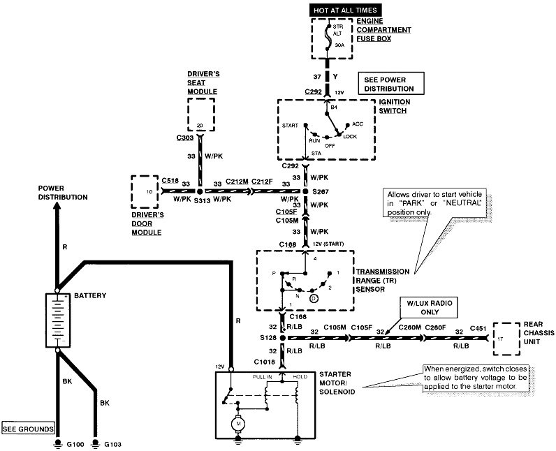

I am not sure which solenoid you are referring too if not the one on the starter. Take a look at the wiring diagram I attached below where it shows the complete starting system and I it doesn't show another solenoid for the starter.
Let us know a little more detail about what the issue is and we can see if we an help. Thanks
Dec 20, 2020 at 9:23 AM
CARADIODOC
  • 34,367 POSTS
There isn't a solenoid on the inner fender like they used for decades, and there isn't even a relay. Starter solenoids can draw up to 20 amps, and the engineers seem to think the little ignition switch and neutral safety switch, (transmission range sensor), can handle the job.
