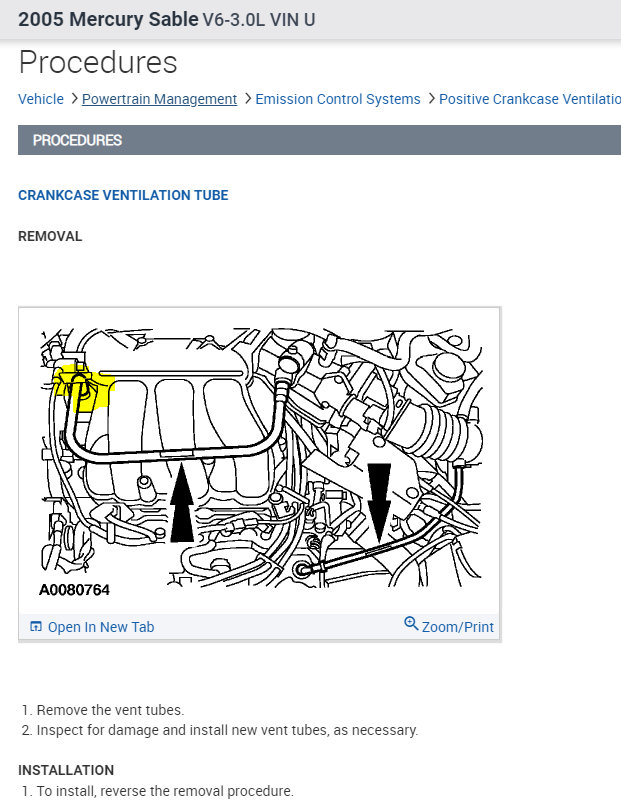

Trying to locate a PCV valve.
Feb 26, 2022 at 1:49 PM
  • 110,241 POSTS
I attached a pic below showing the valve and location. Let me know if you are able to locate it or if you have other questions.
See pic below.

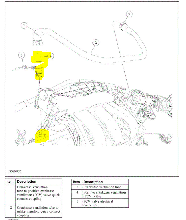

First of all, there was no Sable manufactured in 2007 with the 3.0.
The last year of the 3.0 Sable was 2005.
The PCV is located at the end of the PCV hose. I have attached a diagram for your reference.
Some of these vehicles come with heated PCV valves and have electrical connectors.
