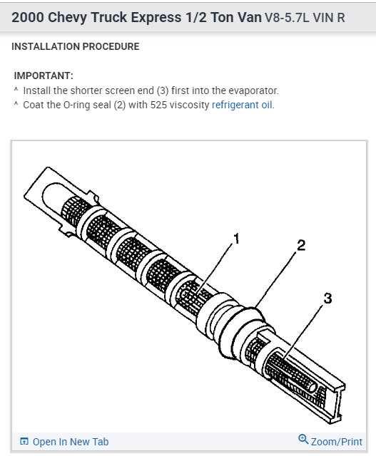

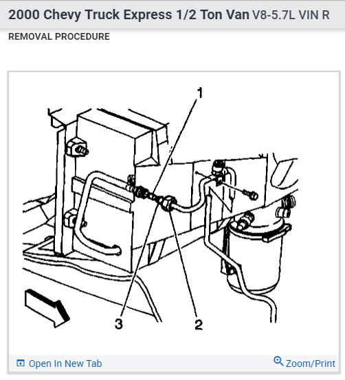

Where is the orifice tube on the vehicle listed above?
Tuesday, July 9th, 2019 AT 8:02 PM
DANNY L
MECHANIC
5,648 POSTS
Hello, I'm Danny.

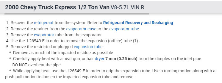

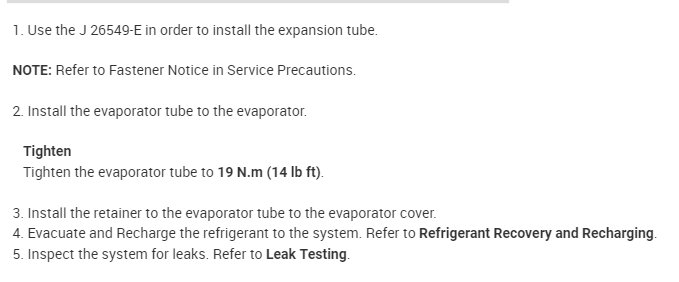

You will have to evacuate and recharge the system to replace the orifice tube. Here is a tutorial showing how to do so:
I've attached a few pictures of its location and step-by-step instructions below.Hope this helps and thanks for using 2CarPros.
Danny-
