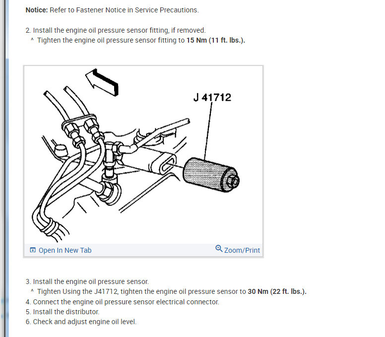

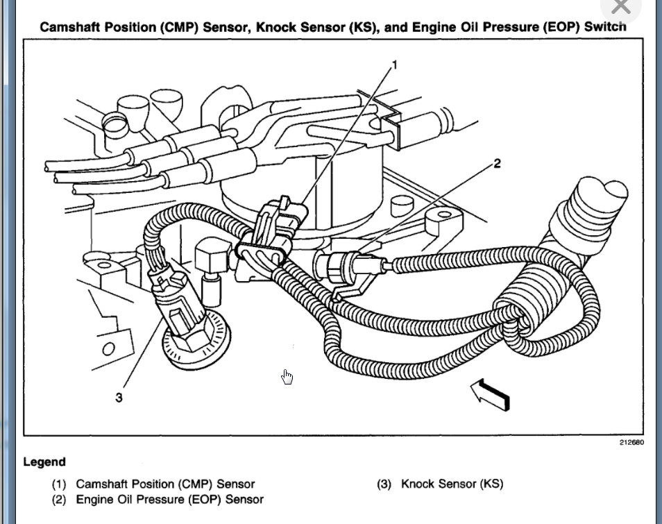

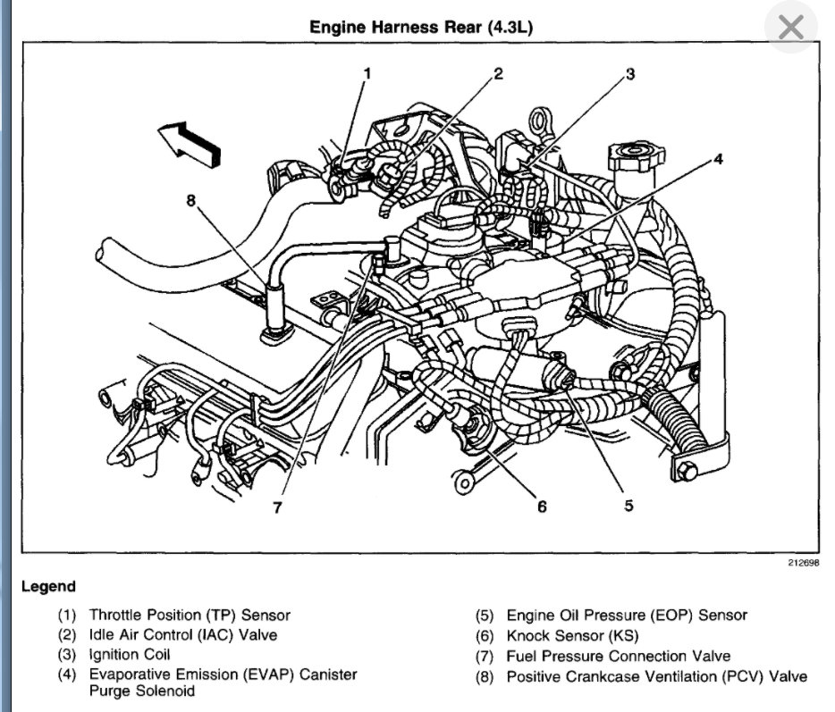

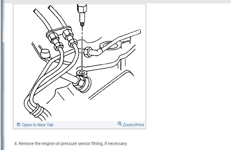

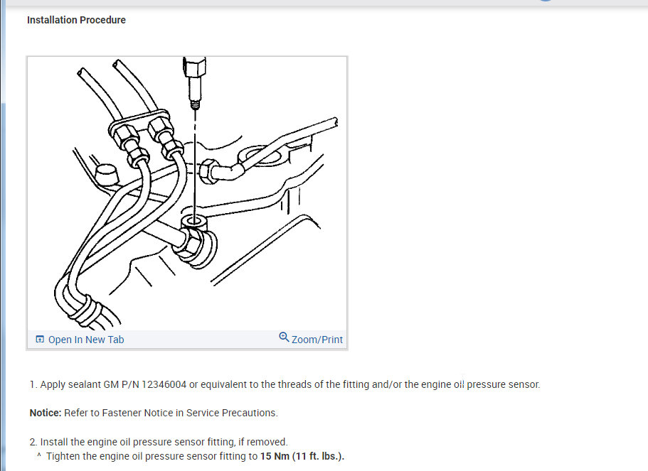

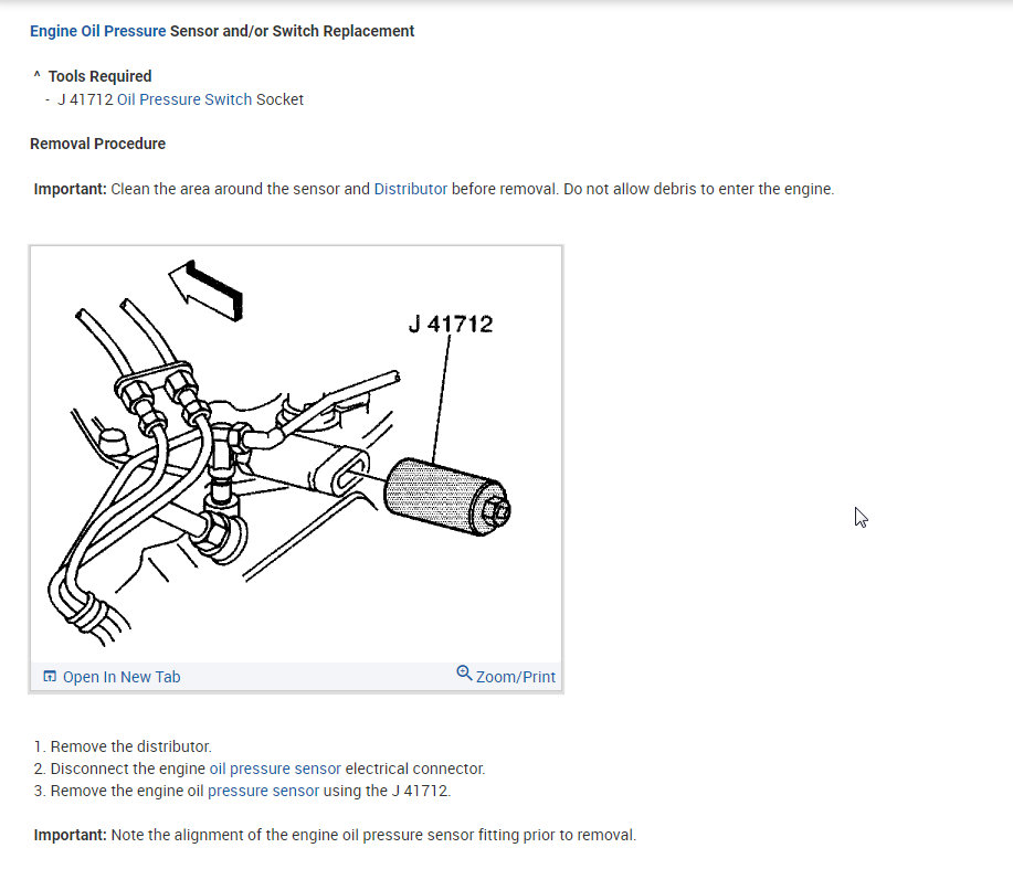

My truck is pouring oil out right above the oil filter and was wondering if it might be the oil sending unit.
Dec 17, 2020 at 5:14 AM
Take a look at the attachments for the oil pressure sender. This is under the distributor so I am not sure it is the issue but I would suggest cleaning off the oil and then starting the engine after you top the oil off and see if you can locate the source.
Here is a guide that can help with this as well:
