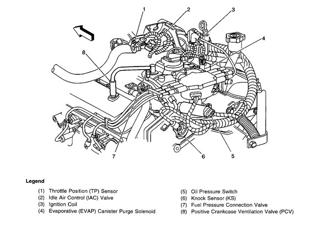

Where is the oil sending unit located on the 4.3 vortec engine and how do I replace it
Oct 12, 2009 at 1:35 AM
JDL
  • 16,098 POSTS
Ths distributor is located back by the distributor. Check out the diagrams (Below). Please let us know if you need anything else to get the problem fixed.

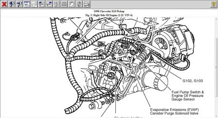

My fuel pump has shut down and the truck wont start. I'll turn the key but can't hear any whirring from the fuel tank. I'm trying to check my bases before draining the tank and pulling the fuel pump. Would the oil pressure switch completely shut down the fuel pump or cut the pressure in some other way? I was told to CHECK the oil pressure switch, is there a way to check it or do i just replace it?
Aug 28, 2019 at 2:34 PM (Merged)
BLUELIGHTNIN6
  • 16,542 POSTS
Oil pressure switch would not shut off fuel pump, however the fuel pump has a secondary route through the oil pressure switch. If the fuel pump relay goes out the pump will then run through the oil pressure switch after the engine gets oil pressure. This results in extended engine cranking time before the engine will start. Have you inspected all fuses, inertia switch (if equipped), relays and wiring before going in for a pump replacement?
Repalce your oil pressure sending unit. Thanks for using 2CarPros.com!

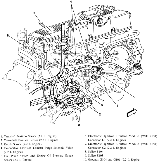

where is the oil pressure sending unit on my truck listed above (2.2)? Also, if it is bad would this make it show no pressure on the gauge?
  • 75,988 POSTS
See below for location.
Check the oil pressure with a mechanical gauge, if normal replace the oil pressure switch. If abnormal could mean oil pump and engine bearing.
HMAC300
  • 48,601 POSTS
the sending unit is on the right rear side of your engine. If it were bad then you would show low or no oil pressure. but to be sure put a mechanical gauge on the engine to see if it is correct or not.

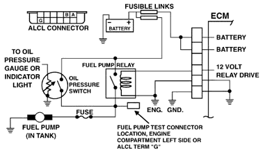

Sounds like you have the wrong sending unit, it had two terminals reversed when it was made, or the plug is in backwards.
GM had some systems that ran the fuel pump off a terminal on the sending unit as a safety cutout. If the vehicle was in a crash that ruptured a fuel line, there would be no fuel pressure so the engine would stall. When it stalled, there would be no oil pressure so the switch in the sending unit would turn off and turn off the fuel pump. That would stop it from pumping raw fuel onto the ground.

I agree with doc on the fact that you likely have either a bad or the wrong oil sender. It is used as a redundant power supply for the fuel pump but it IS NOT a low pressure cut off. It does not have the ability to interrupt the fuel pump, it can only power it in the case of a relay failure.

  • 75,988 POSTS
All you got is 2secs to look for power at the gray wire anything over 2 sec you ain't gonna have it the fuel pump relay de-energizes which is controlled by the computer-When the engine fires up the oil pressure sending unit powers the pump see below-
https://images.2carpros.com/forum/automotive_pictures/12900_oil_sending_unit_and_fuel_pump_circuit_34.gif

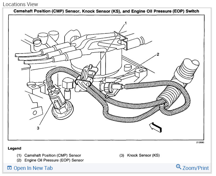

Where is the water temp sensor and the oil pressure sensor located on the engine? The engine is a 2.5L 4 cylinder in a 91 chevy s10.
Aug 28, 2019 at 2:35 PM (Merged)
  • 75,988 POSTS
2.5L VIN E oil pressure switch located at oil filter flange
2.5L Coolant Temperature Sensor On thermostat housing
