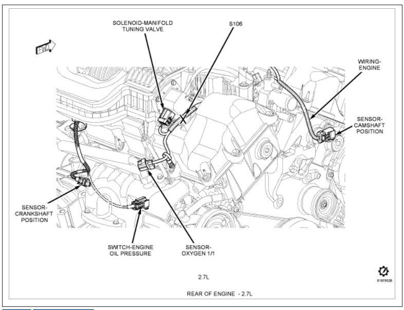

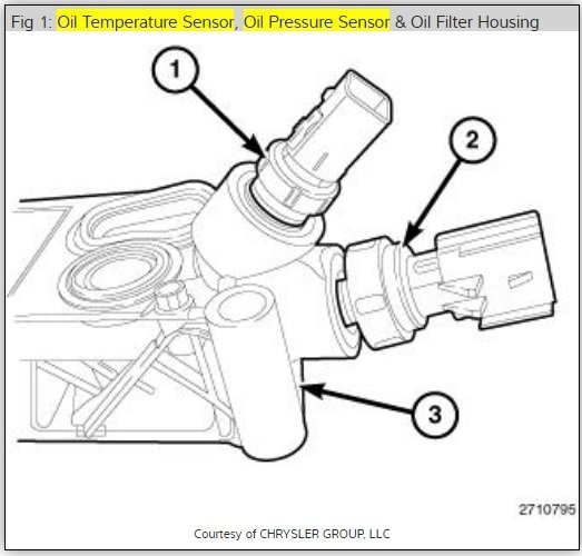

Can you tell me where the oil pressure switch is located? I bought a new one and need to change it out but the manual does not tell me where it is located.
Aug 23, 2018 at 6:19 AM
CJ MEDEVAC
  • 11,004 POSTS
Number 2 is the oil pressure sensor, it has three wires. Number 3 is the oil filter housing. Check out the diagrams (Below). Please let us know if you need anything else to get the problem fixed.

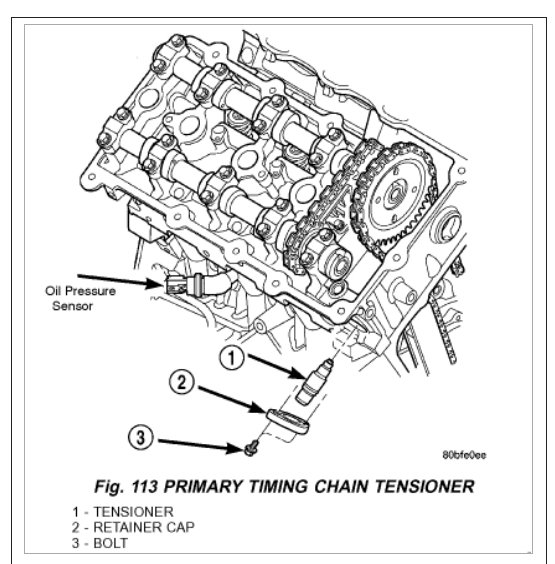

It looks like it is down low on the engine block here is a guide to show you the location. Check out the diagrams (Below) both engines. The sender should cost about $35.00 and labor should be about $60.00. Please let us know if you need anything else to get the problem fixed. Cheers

I have an oil leak and have traced it down to my oil sending unit. But I am unsure what is the easiest and best way to get to it?
Jan 8, 2021 at 11:13 AM (Merged)
HMAC300
  • 48,601 POSTS
It should come off from the bottom, it may take a special socket as well.
