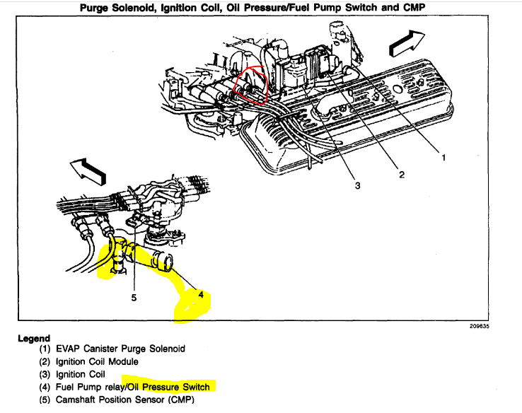

Where is the Oil Pressure Sensor, engine is a 5.7L Vortec 7400.
1998 CHEVROLET 1500
178,000 MILES • 5.7L • V8 • 4WD • AUTOMATIC
THE RANDO CHEVY LADY
I've looked up multiple diagrams on the internet and there are far to many. So Lets ask the experts. Where is it?
Aug 26, 2024 at 11:42 AM
  • 110,244 POSTS
The oil pressure switch should be right next to where the distributor is located on the rear of the engine.
I attached a pic below. I highlighted the sensor on one section and circled where I believe you will find it.
Let me know if this helps.
See pic below.
