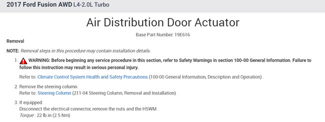

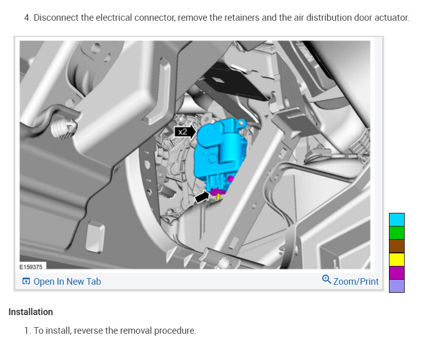

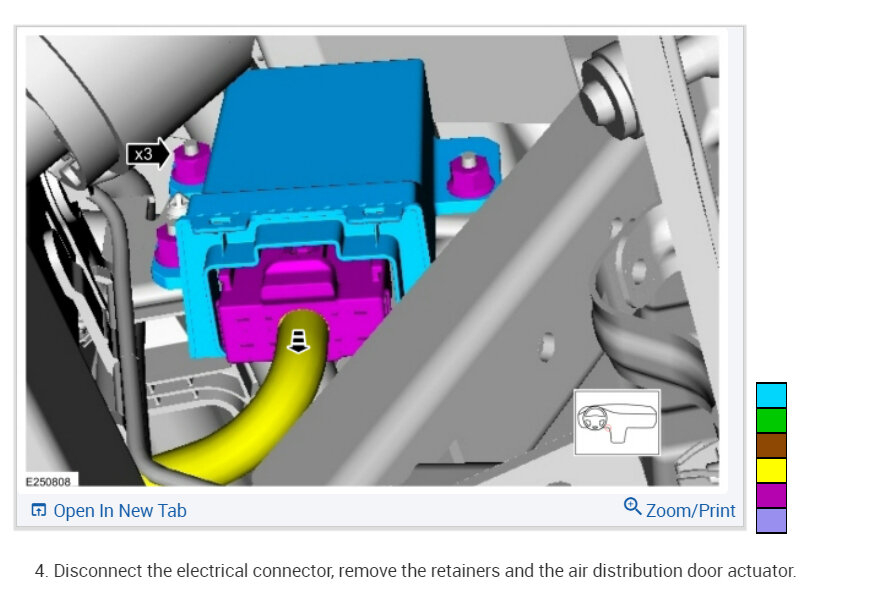

No air out of defroster. I want to know the location of the mode door actuator.
Oct 29, 2022 at 4:37 AM
  • 55,649 POSTS
They call it an air distribution actuator and it is under the dash on the passenger's side, here are the instructions on how to replace it in the diagrams below. Check out the images (below). Please let us know what happens.
