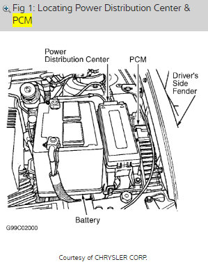

The dash and head lights will stop working randomly.
Jun 25, 2018 at 5:56 PM
DANNY L
  • 5,648 POSTS
Hello, I am Danny.

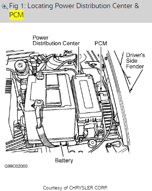

The BCM (Body Control Module) is located on the junction block, behind left side of Dash. PCM (Powertrain Control Module) is located Left side under hood. Picture attached. The headlight relay is located in the Power Distribution Center. Sounds like a loose wire/connection. Hope this helps!
