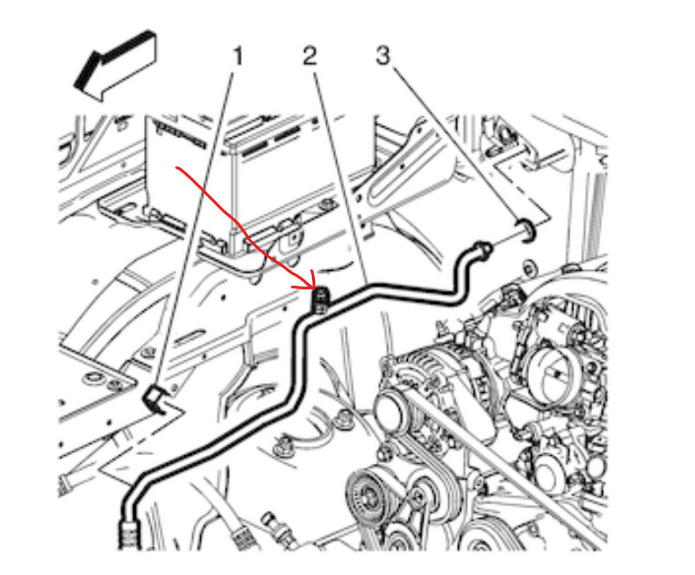

Where is the low side for the A/C trying to make it blow cold air?
2017 CHEVROLET TAHOE
89,765 MILES
TYREACEHOUSE1988
MEMBER
1 POST
Trying to make it blow cold air?
May 14, 2023 at 6:49 AM
Experienced Mechanic
55,851 POSTS

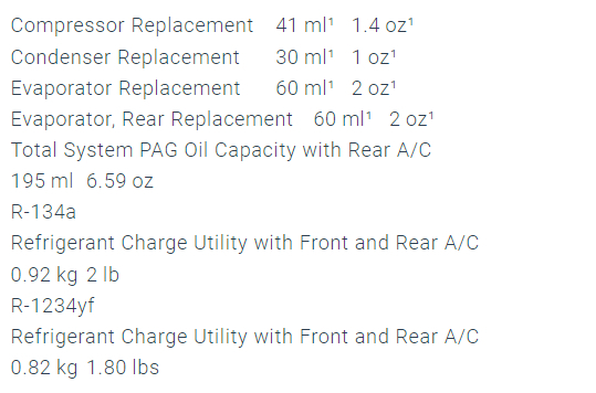

This vehicle can have either 134a or 1234yf so the fitting will be different. Here is the location in the image below. This guide can help as well:
https://www.2carpros.com/articles/air-conditioner-how-to-add-freon
