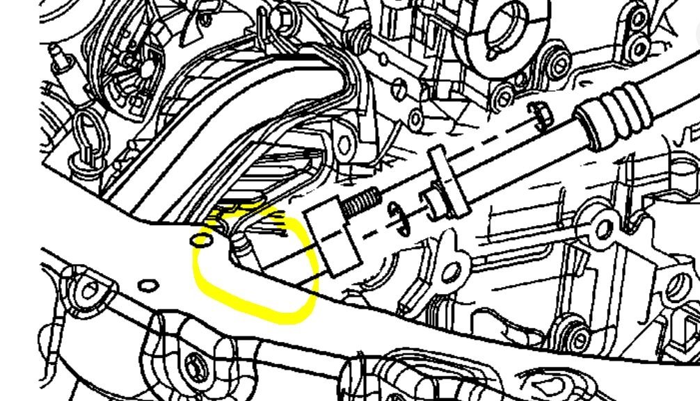

I want to change out the ECT. Is there more than one ECT? When I look at the diagram, it shows 7. Where is the p0117?

There is only one coolant sensor. I attached a picture for you to view the location.

I don't see it Roy.

It is at the very back of the motor by the firewall by the diagram.
If not, please give me the complete VIN number.

I found it. It wasn't on the thermostat housing but it was nearby.
