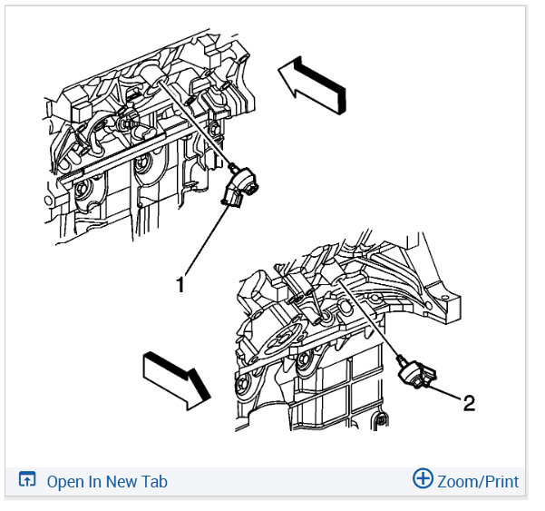

Location to bank 1 on a 09 Lucerne cxl 3.9l v6.

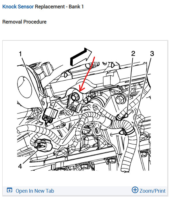

The knock sensor bank 1 is on the right side of the engine block just below the cylinder head. Here are the locations so you can see in the images below. Let us know if you need anything else.

Do I have to remove Intake manifold to access it?
Jun 19, 2025 at 6:09 AM
  • 55,542 POSTS
Fortunately not, it is on the outside of the engine block just below the cylinder heads.

On the front of the engine by the exhaust manifold or on the rear of engine by catalytic converter?
Jun 20, 2025 at 1:28 PM
  • 55,542 POSTS
The knock sensor bank 1 is on the right side of the engine block (middle) just below the cylinder head.
