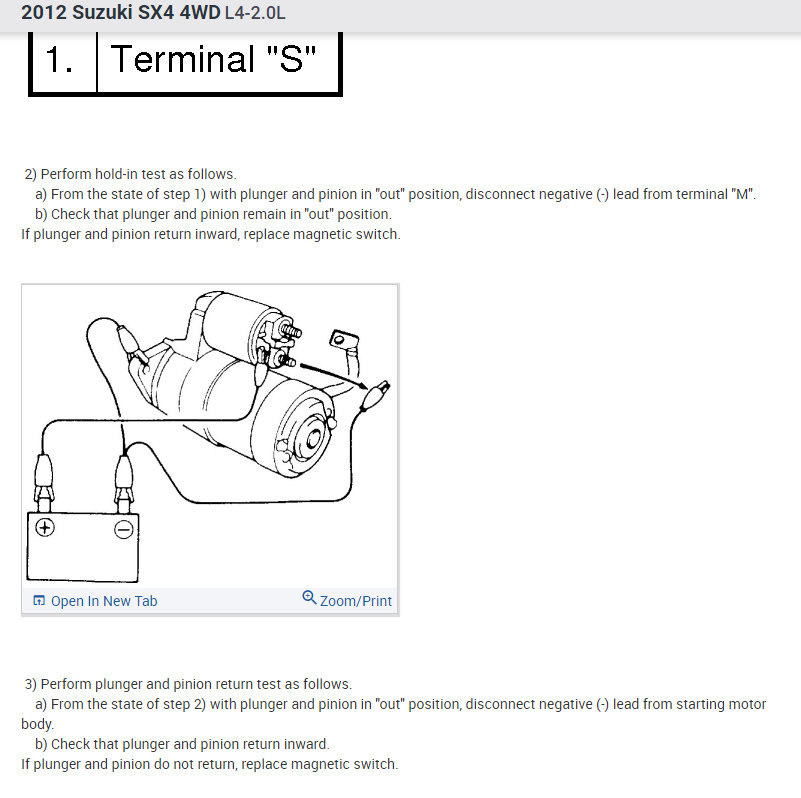

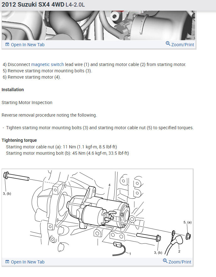

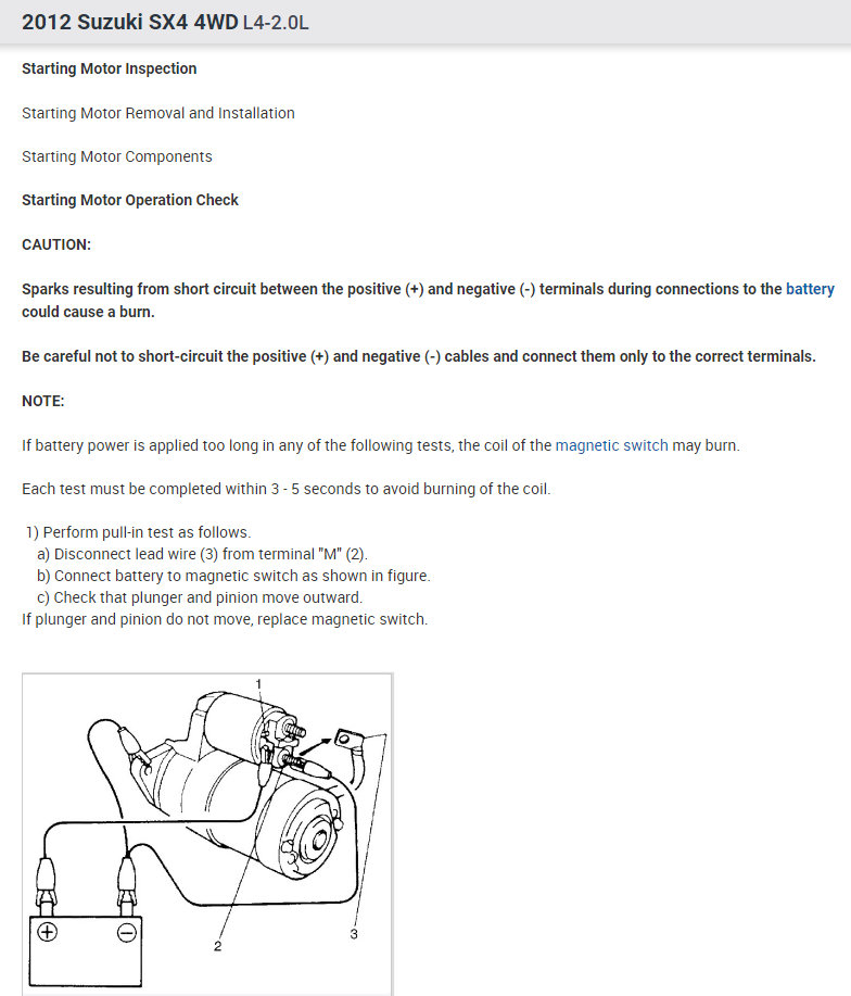

would like a diagram showing where it is located. thanks
Sep 28, 2021 at 1:44 PM
SQM
  • 6,383 POSTS

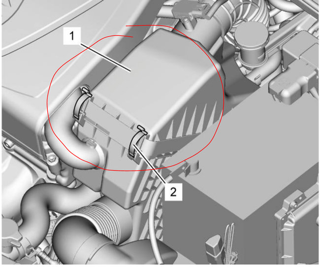

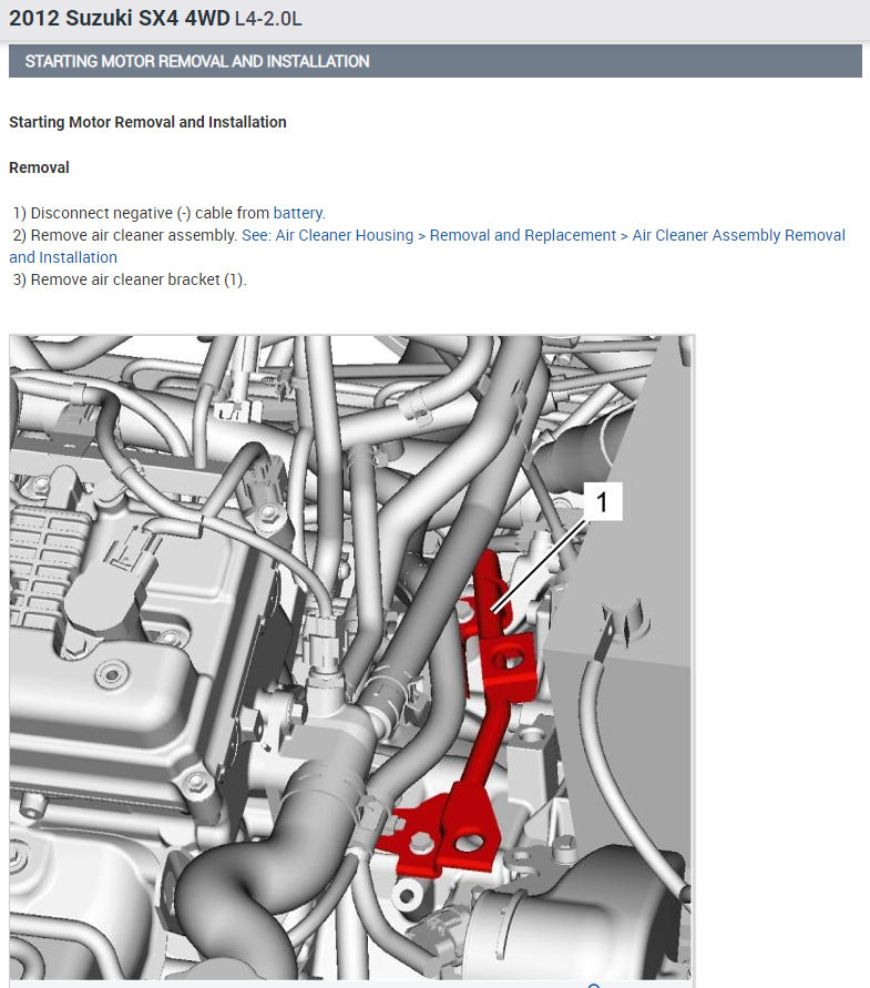

The starter is located on the lower right side (if you are facing the engine) of the engine bay.
You will have to remove the air filter box to be able to access it.
Attached are the replacement instructions below.
