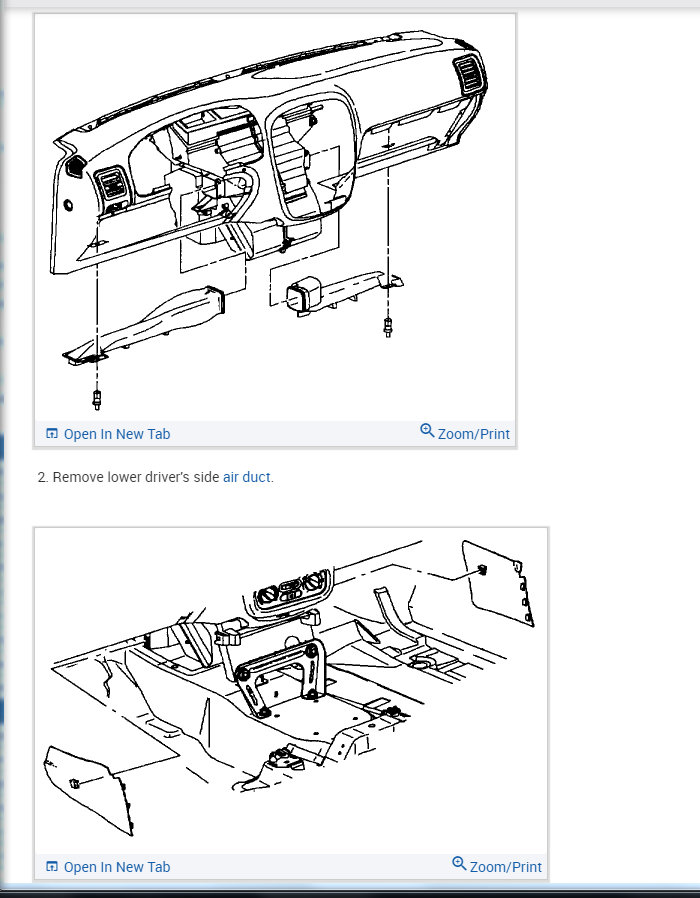

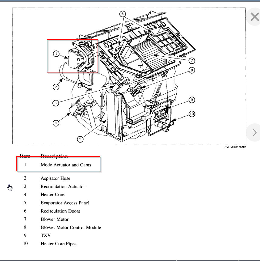

You are correct. If you hear the clicking behind the radio then most likely the actuator is stripped and not able to actually move the door. This actuator is on the left side of the HVAC housing which would put it just behind the radio.

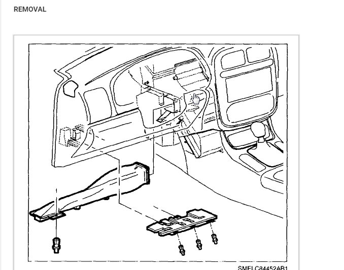

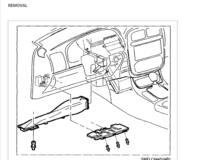

You can access it by removing the lower trim on the driver side. Take a look at the rest of the attachments.

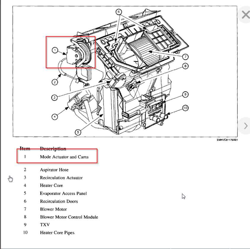

So you are going to be looking from the driver side towards the passenger side and it will be on the side of the HVAC housing closest to the driver side.
Unfortunately it is not the easiest one to find and more then likely you will be laying on your back on the driver side floor in an awkward position in order to find it.

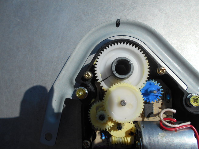

I found it and it was on the passenger side, the same side the actuator for the re-circulation is on. took it apart and that large plastic gear is cracked.
I might just buy that gear and replace it. I appreciate your help, it helped me out a whole lot.Thank you

I am so sorry. They normally orient these pictures as if you are looking at it from the driver seat so I never gave it a second thought. Take a look at the picture again and I put a blue arrow at the heater core tubes. That is going out to the engine so this is actually spun around.
That is frustrating. Sorry again and glad you got it figured out. Thanks for the update, I am sure that will help others and not just me. Thanks

My gear is broken, the auto parts stores do not sell that part and the cheapest I could find it online was $86.00 plus shipping and tax so I just ordered the gear for about $16.00.
What tipped me off was the re-circulation actuator being on the same side, I had already been to that actuator so I knew they were both on the same side. Thanks again.

Here is the picture of the broken gear, it has 51 teeth or gears, whatever you might want to call them but I ordered this gear from eBay. I haven't received the gear but will let you know the outcome where you might be able to help someone else.

That's possible, that gear should be here Saturday. will let you know the results, bought the gear (51 teeth or gears) on eBay . GM doesn't stock that complete assembly anymore so we must buy the broken gear or go to the junk yard for one.
