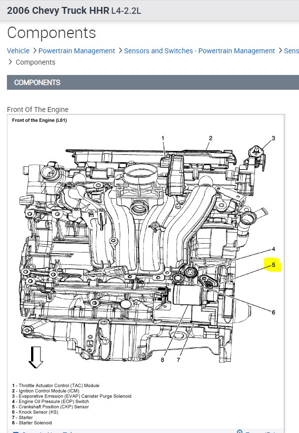

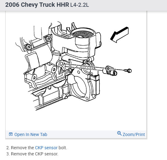

Where is the crank shaft position sensor located? Please help.
Jul 15, 2022 at 2:45 AM
SQM
  • 6,383 POSTS

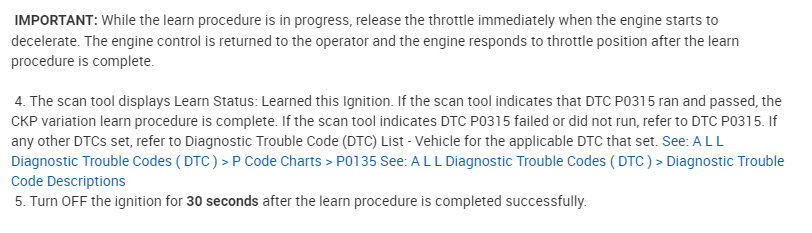

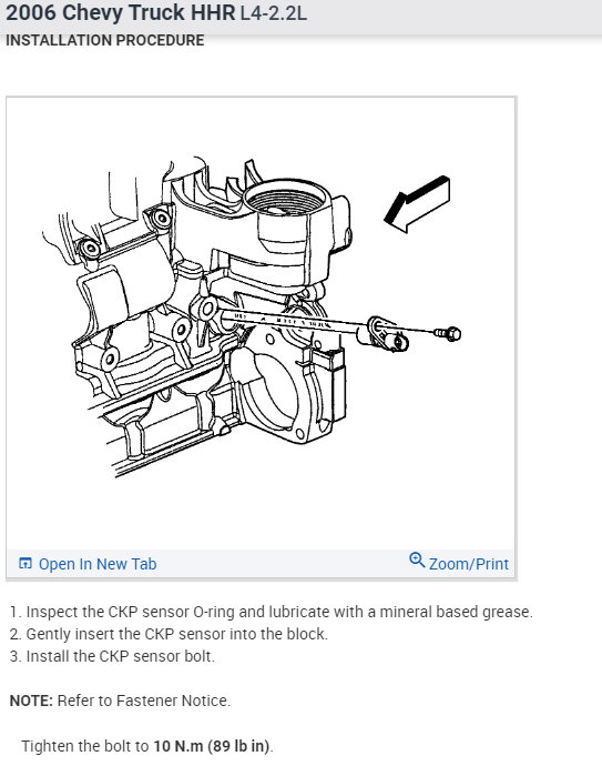

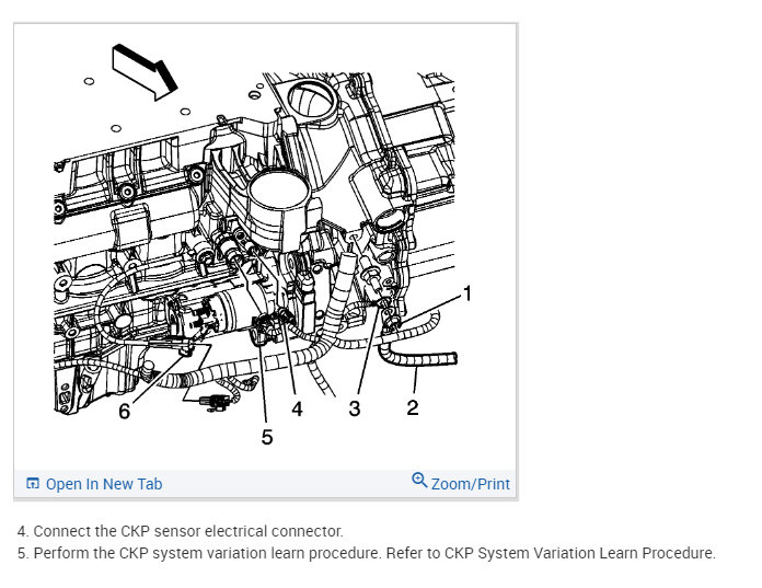

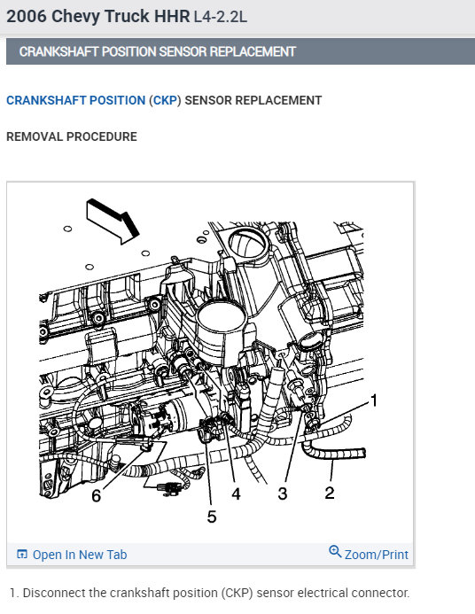

The crankshaft position sensor is located on the driver side lower part of the engine (see diagram below).

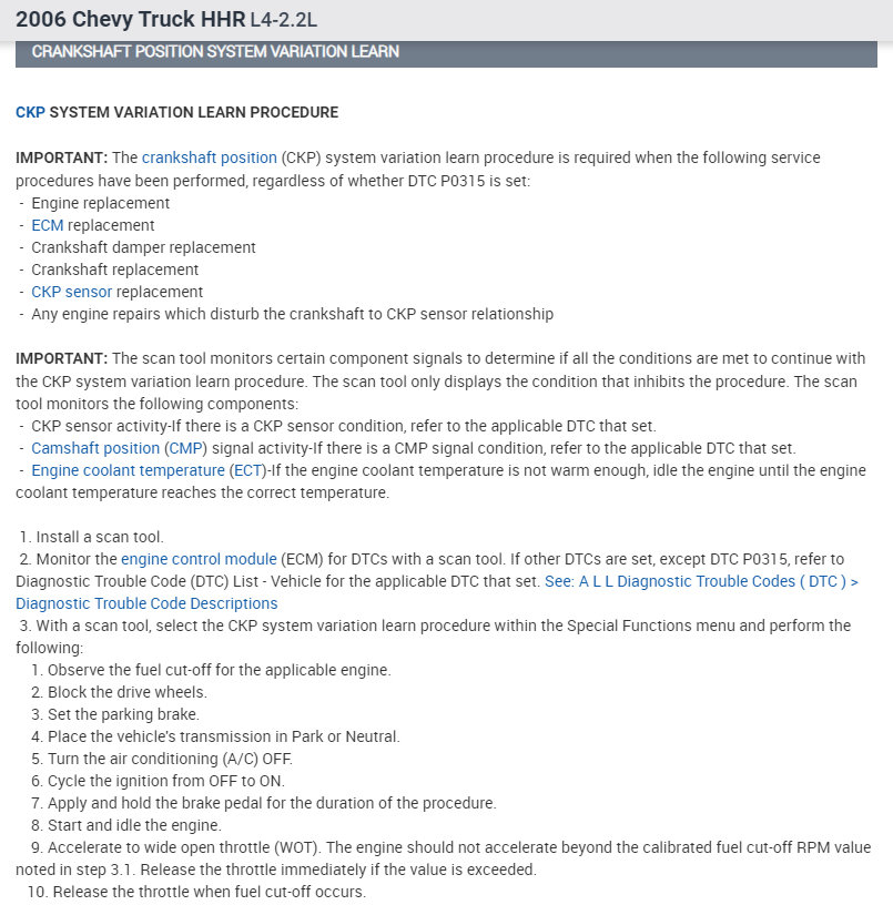

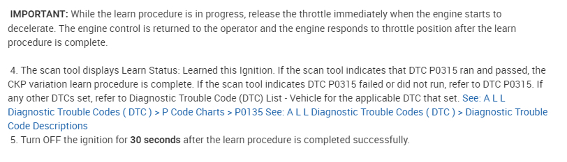

Keep in mind that this crank sensor requires programming after replacement.
I have attached the replacement as well as the programming procedure below for your reference.
Let me know of any questions.
