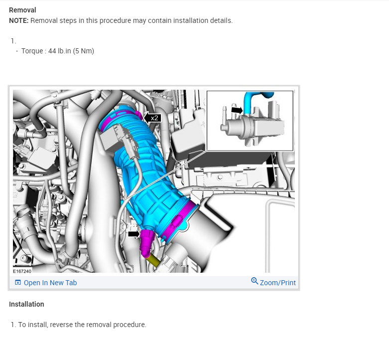

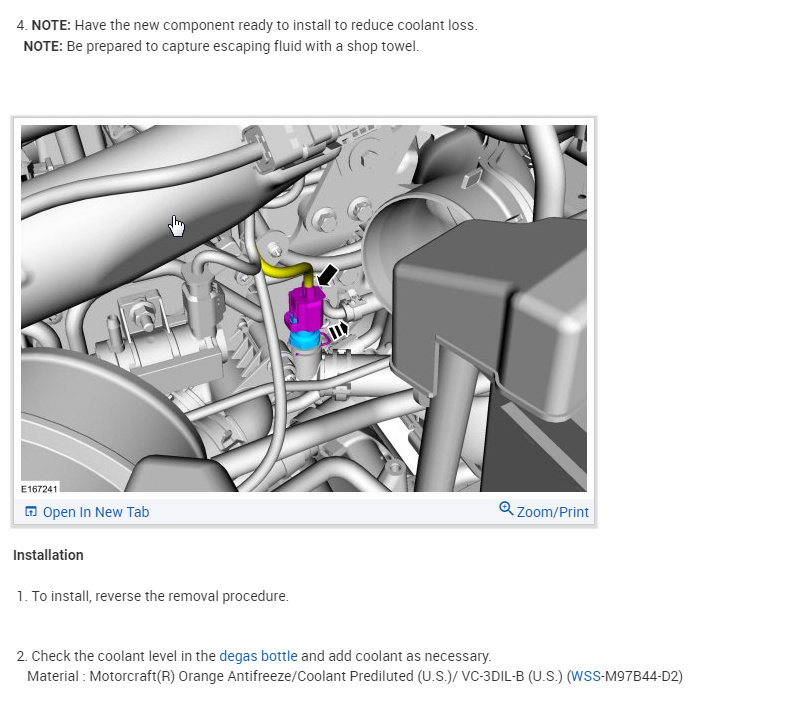

CHT sensor location i need to change it out can you help me?
Jul 24, 2019 at 7:23 AM
Hi AKCUZZ,
Here is what the manual shows for this location. Let me know if you need more information. Check out the diagrams (Below). Please let us know if you need anything else to get the problem fixed. Thanks
