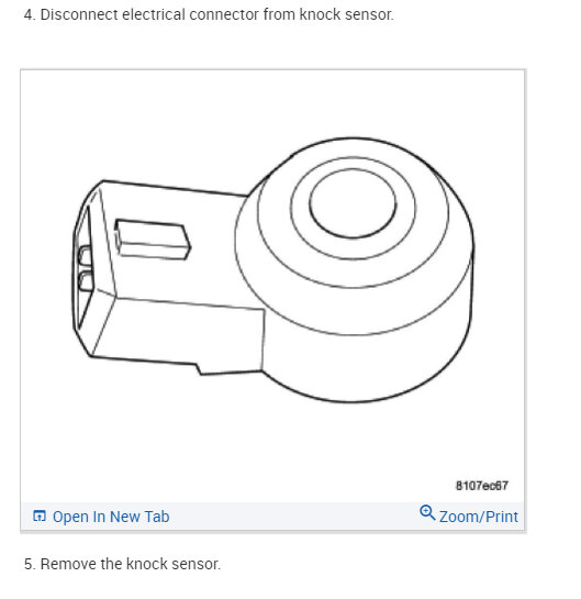

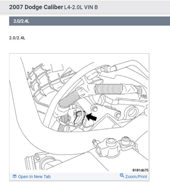

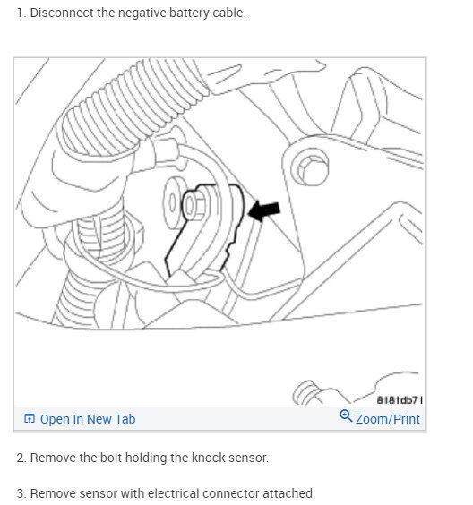

The knock sensor bolts into the side of the cylinder block in front of the starter under the intake manifold.
I attached the directions below for the removal and replacement of the component, so you have a guide.
When installing the new one, it is very important it is properly torqued. See the last pic for specifications.
