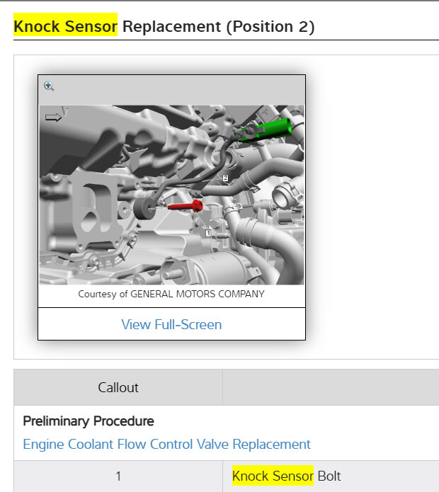

Codes P0333, P0331, and P06B7, where is the knock sensor 2 circuit high bank 2 Located?
2021 CADILLAC CT6
21,007 MILES • 2.0L • 4 CYL
ARNULFO ARANA
I have a check eight light on, code P0333 P0331 and P06B7.
Jun 27, 2023 at 8:23 PM
  • 54,832 POSTS

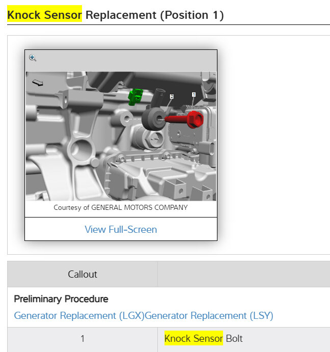

There are two knock sensors, one on each side of the engine, I have included the locations of both knock sensor in the images below and here is more information on the codes:
P0333 - Knock Sensor 2 Circuit High Input Bank 2:
P0331 - Knock Sensor 2 Circuit Range/Performance Bank 2:
P06B7 - Sensor Reference Voltage "C" Circuit Low:
