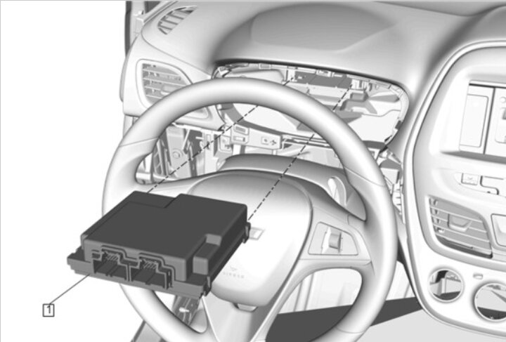

Where is the keyless entry control module located on my car?
43,000 MILES • 1.4L • 4 CYL • 2WD • AUTOMATIC
MCOX8051
Both of my key fobs quit working. I have disconnected the battery to try and reset the system, it did not work. I believe the receiver module is bad, part number 13595510. I have a new one but I do not know where it is located on my car to change it.
Aug 20, 2025 at 10:20 PM
  • 55,826 POSTS
The keyless entry control module is located at the left side of the dash directly behind the gauge cluster. Check out the images (below). Let us know if you need anything else.
