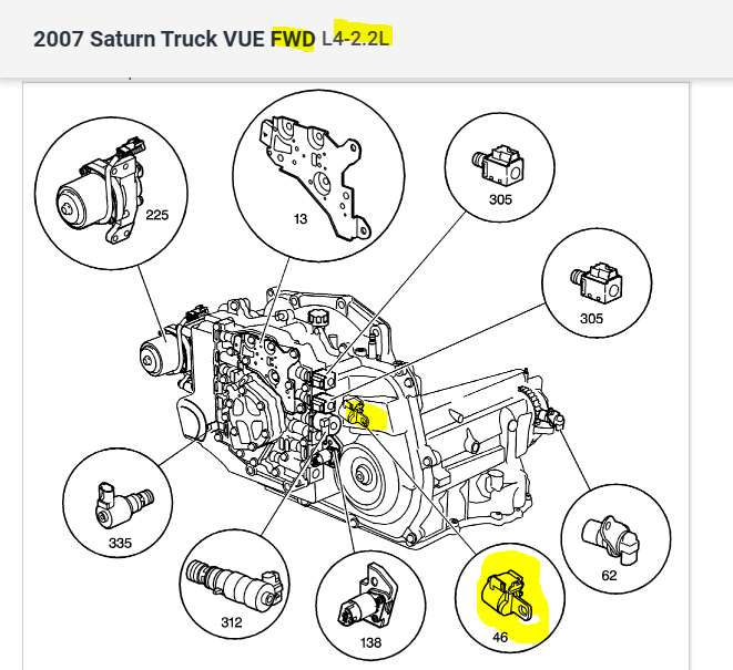

Where is the input speed sensor location on the transmission?
Nov 11, 2024 at 11:32 AM
  • 110,194 POSTS

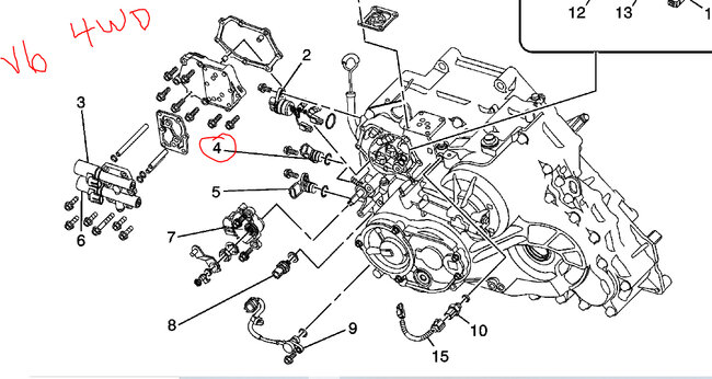

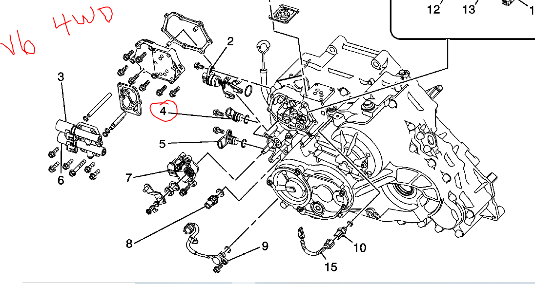

I need to know if this is a 4-cylinder 2wd. The V6 was the only engine offered with AWD. If I use the one for AWD, it is for a 3.5L engine. If I use a 2.2L engine, it is for a 2wd. vehicle. I attached general pics of both below, but I'm not sure which one you need.
Nov 11, 2024 at 6:29 PM
LINNAP1019
It's a 4 Cylinder 2007 Saturn Vue FWD. I'm having a hard time finding the input and the output Vehicle Transmission Speed Sensor.
Nov 11, 2024 at 6:45 PM
  • 110,194 POSTS

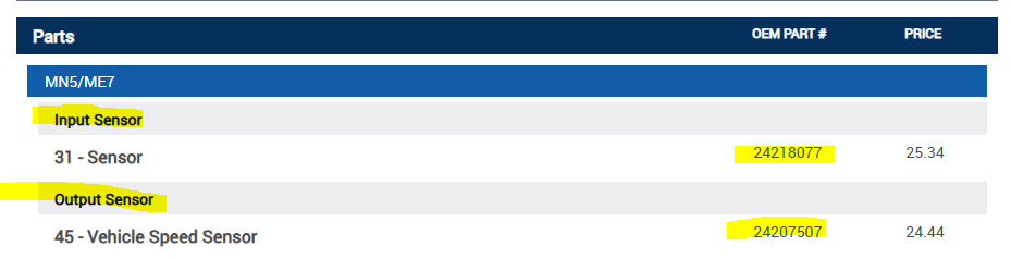

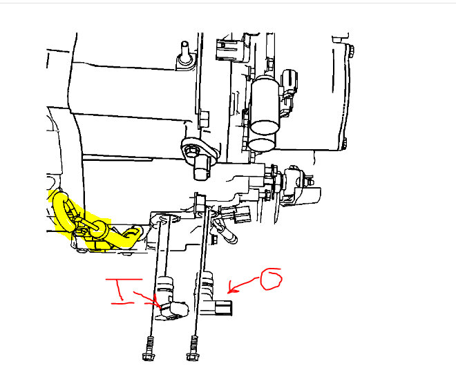

That makes it a lot easier. LOL They both are located behind where the transmission dipstick tube is mounted on the transmission. I attached a pic below. (pic 1).
My manual doesn't indicate which one is which, so I also attached the OEM part numbers which are different. Take one of the two out. Clean it off and locate the part number to determine if it is the input or output sensor.
Strictly from memory, I believe the one closest to the dipstick is the input.
Let me know how things turn out or if you have other questions,
