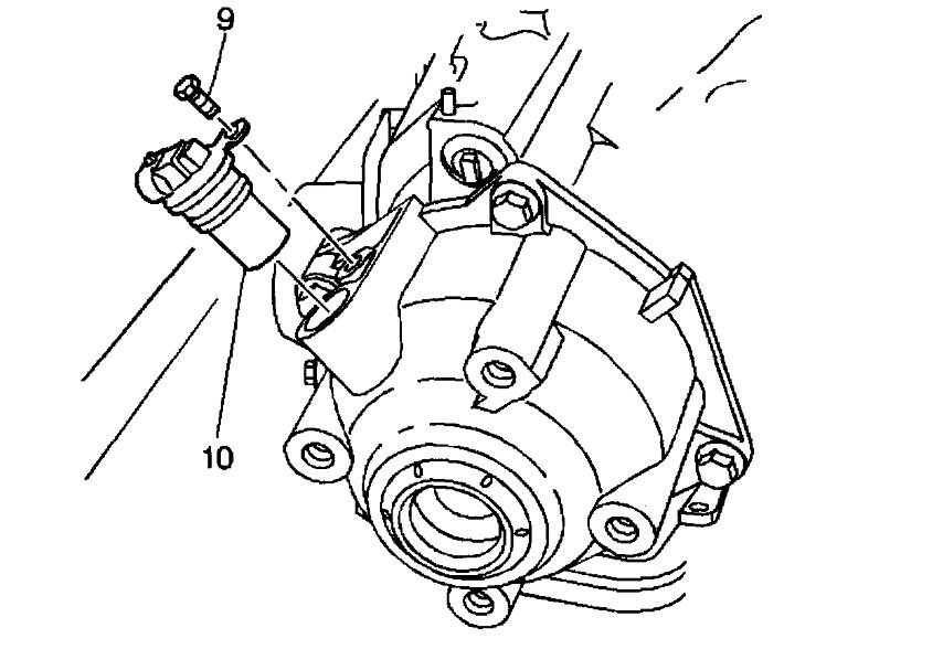

Speedometer still not going the right speed and car is like it does not want to shift because it don't know the right speed it's going.
Apr 10, 2020 at 7:59 AM
Good morning,
Do you have any codes set in the system?

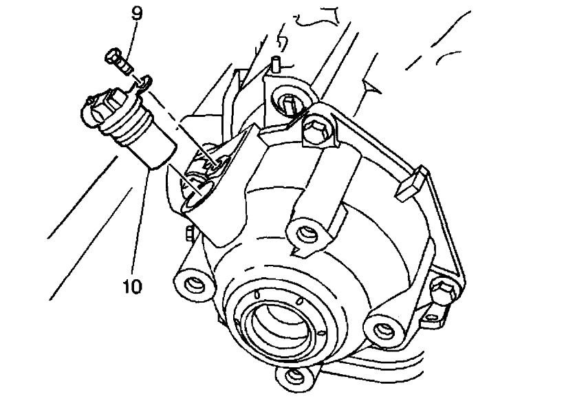

If the speedometer is not working, that is the vehicle speed sensor, not the input speed sensor. This will also effect the shifting points as well.
1. Raise and support the vehicle. Refer to Vehicle Lifting.
2. Remove the right front tire and wheel.
3. Remove the vehicle speed sensor VSS electrical connector.
4. Remove the VSS bolt (9).
5. Remove the VSS (10) from the extension case.
6. Remove the O-ring (11) from the VSS (10).

Hi there, I do not have a code and i have changed the speed sensor and it still doing the same thing. maybe I got a bad one.

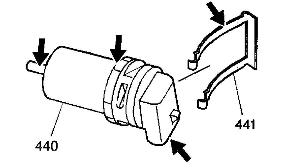

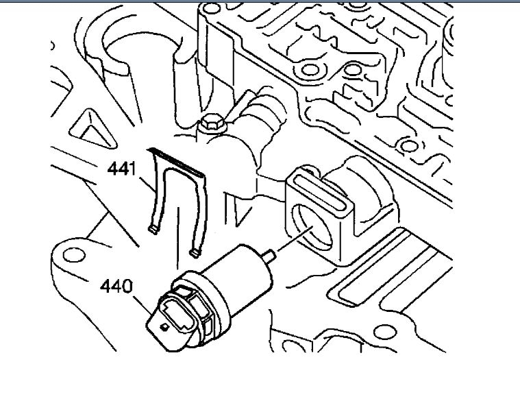

No, I do not. but just for I can know where would the input speed sensor be located? they say to change both when you do it and maybe I bought a bad output speed sensor.
Apr 10, 2020 at 8:41 AM
Okay, I attached the location and the procedure for the input speed sensor.
Again, it has no effect on the speedometer working at all.
That is controlled by the vehicle speed sensor.
Can you get a scan tool to do the readings?
1. Remove the case side cover.
2. Disconnect the input speed sensor electrical connector.
3. Remove the input speed sensor clip (441) from the case cover.
4. Remove the input speed sensor (440) from the case cover.
5. Inspect the input speed sensor (440) for the following conditions:
Damaged or missing magnet
Damaged housing
Bent or missing electrical terminals
Damaged speed sensor clip (441)
Apr 10, 2020 at 8:48 AM

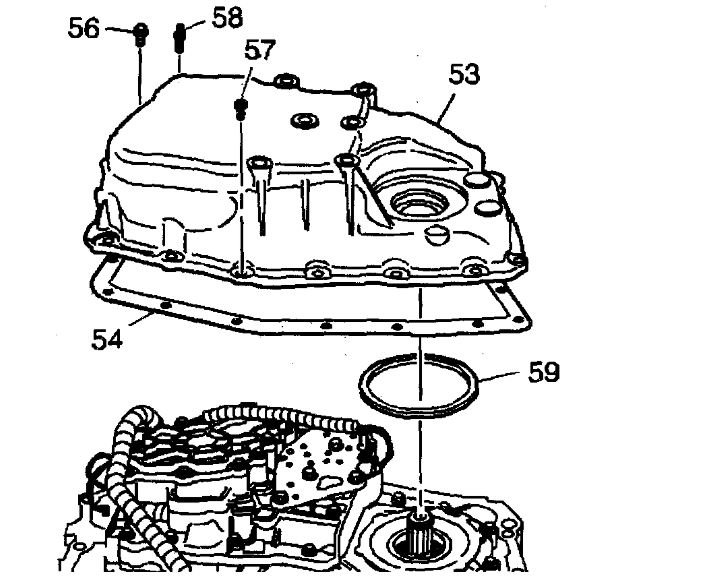

You have to take the side cover off the side of the transmission as in the instructions. It is on the valve body.
I posted the procedure below.
Case Side Cover Replacement
Removal Procedure
1. Disconnect the negative battery cable.
2. Remove the air cleaner intake duct.
3. Remove the engine mount struts.
4. Install the engine support fixture.
5. Disconnect the transmission wiring harness connector.
6. Raise and support the vehicle. Refer to Vehicle Lifting.
7. Remove the left drive axle from the transaxle.
8. Secure the drive axle to the steering knuckle/strut.
Caution: Failure to disconnect the intermediate shaft from the rack and pinion stub shaft can result in damage to the steering gear and/or damage to the intermediate shaft. This damage may cause loss of steering control which could result in personal injury.
9. Remove the intermediate steering shaft pinch bolt and the shaft from the steering gear.
10. Remove the 3-way catalytic converter pipe from right exhaust manifold.
11. Support the right and the left side of the frame with jackstands.
12. Remove the transaxle mount.
13. Loosen the engine mount lower nuts.
14. Loosen the right side frame bolts and remove the left side frame bolts.
15. Adjust the jackstand to the lower left side of the frame.
16. Position the drain pan under the transaxle.

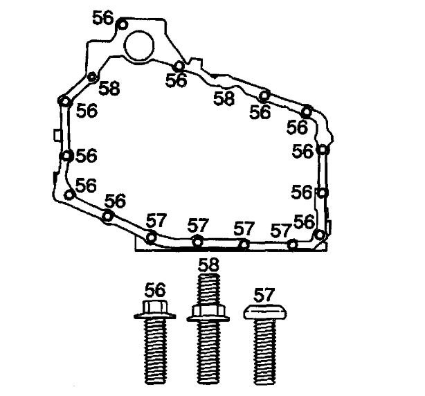

17. Remove the case side cover bolts (5-58).
18. Remove the case side cover pan (53).
19. Remove the case side cover gasket (54).
20. Clean the case.
21. Clean the side cover gasket mating surfaces.

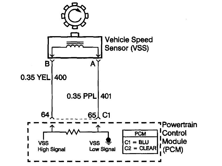

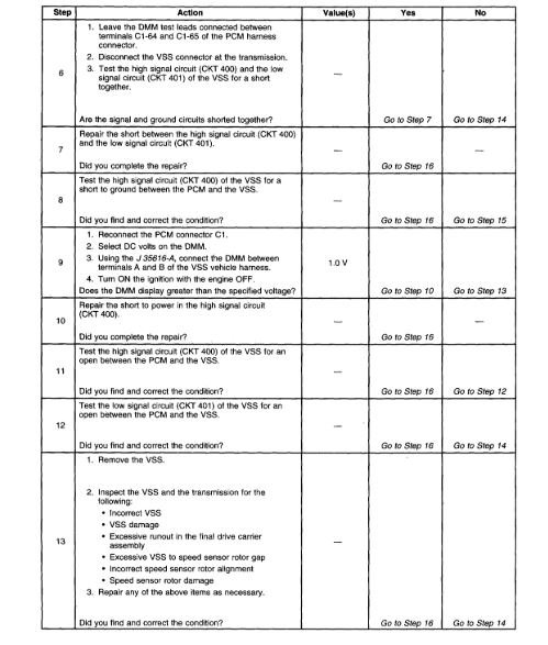

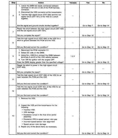

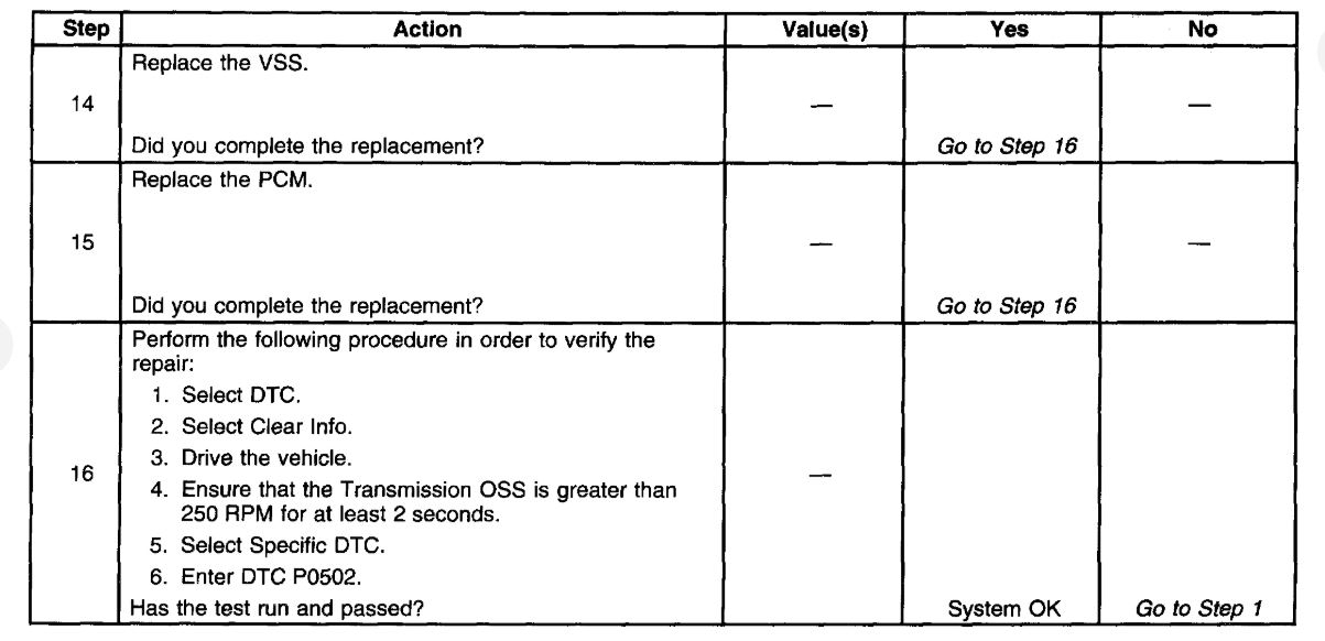

Hi there. I finally have the code it is P0502 it is the speed sensor that I changed. I think I bought I defected one from Amazon.
May 4, 2020 at 2:56 PM
Okay, this code is for the vehicle speed sensor which is different from the input speed sensor.

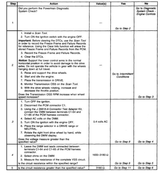

I attached a flow chart with a wiring diagram. Does the speedometer work?
I posted below the description and a flow chart for you to follow.
Circuit Description
The Vehicle Speed Sensor (VSS) system is a pulse generator consisting of a speed sensor assembly, located in the case extension, and a toothed vehicle speed sensor reluctor wheel, which is pressed onto the final drive carrier assembly. As the vehicle drives forward, the vehicle speed sensor reluctor wheel rotates. This rotation produces a variable AC signal in the pickup coil that is proportional to vehicle speed. The PCM uses this signal in order to calculate vehicle speed, shift timing and gear ratios.
If the PCM detects a low vehicle speed with a high engine speed while in a drive range, then DTC P0502 sets. DTC P0502 is a type B DTC.

May 4, 2020 at 3:16 PM
FRESHLIKE78
  • 14 POSTS
The speedometer does work but it goes up and then back down and then it might stop and then it will go back up and down then the car will jerk.
May 4, 2020 at 6:03 PM
Okay that is why the code is setting.
You have an erratic reading and that will set the code. I would replace the sensor and make sure the connector pins are clean, tight and not damaged.
