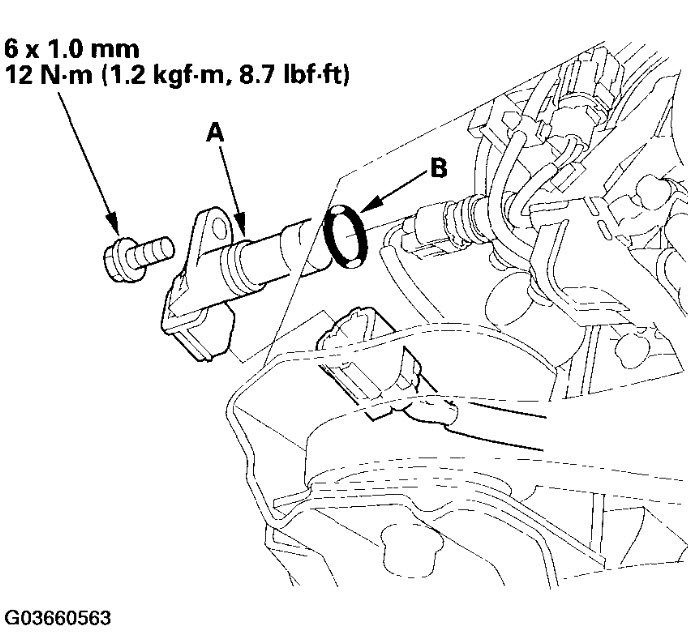

Need to replace the input shaft speed sensor. Where is it located?

i am assuming it is a manual shift as you did not put it in what it is other than a car model.

It is an automatic transmission.

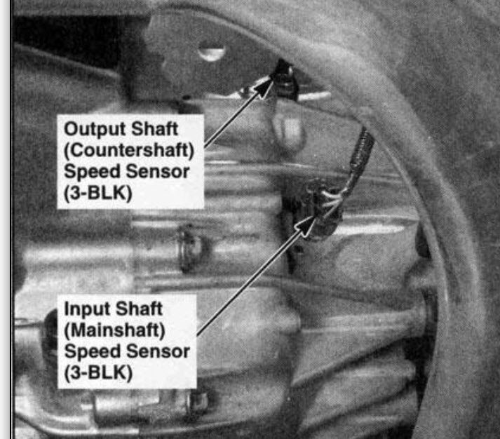

there is a shield that must be removed to access it. see picture.

Where is that located?

under the car by cooling lines in transmission.
