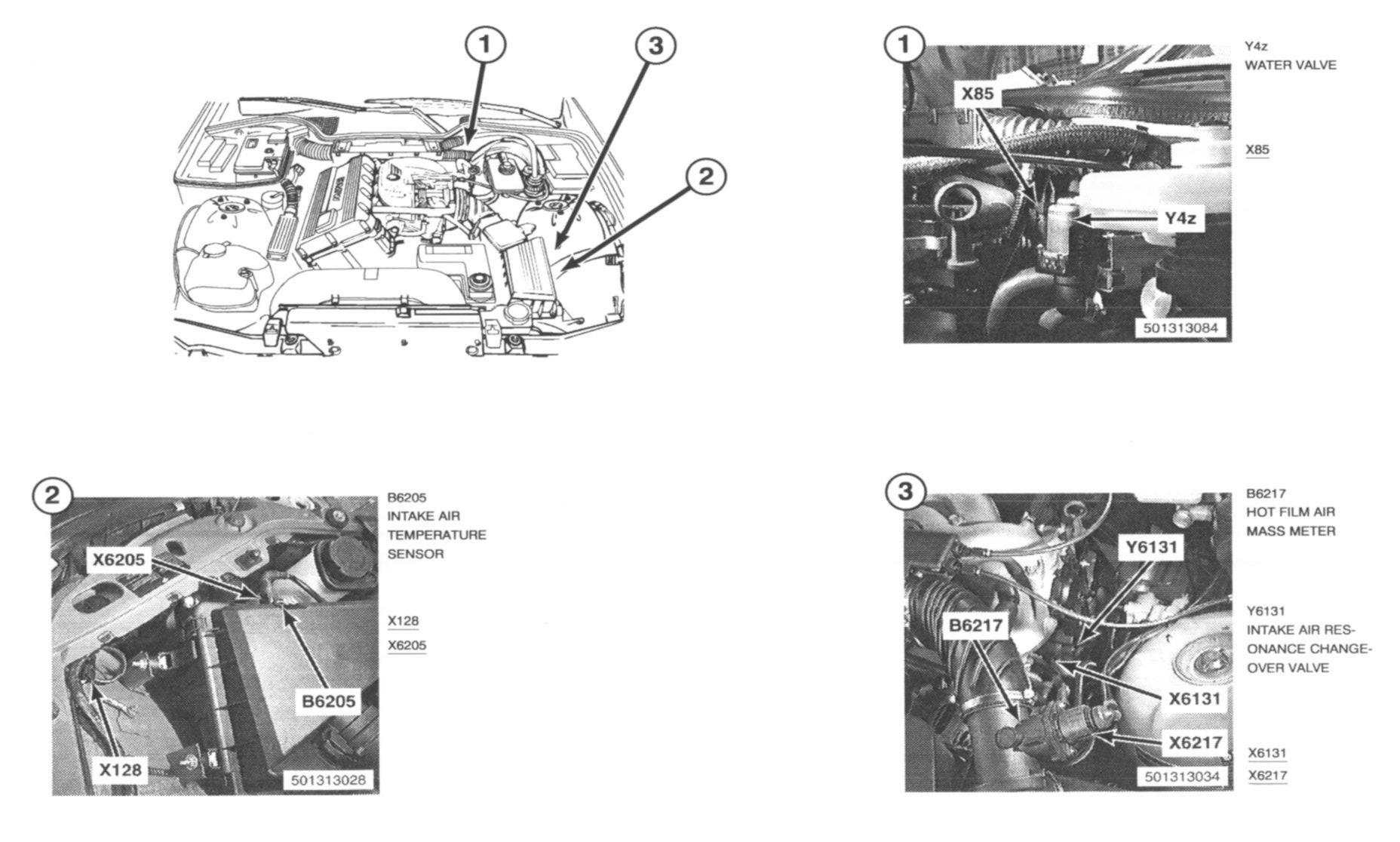

where is the IAT

I have attached a picture of different components including the IAT. Here is the legend for the requested part.
Component Location View
Figure 2
Component ID B6205, Intake Air Temperature Sensor
Location Front left hand side of engine compartment
