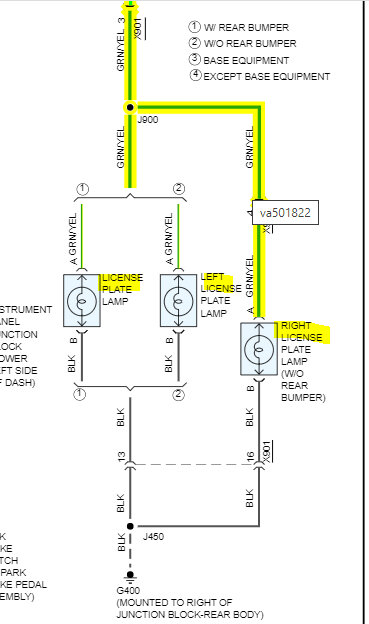

Where are the fuses for the tag lights located?
2016 CHEVROLET SILVERADO
126,000 MILES
KOLTON1713
I’m having trouble with my new tag lights I’m trying to put in and they won’t come on.

The power to the license plate lights is provided via the body control module and not directly from a fuse.
I attached the schematic showing the lights. With the headlamps or parking lamps on, check the green wire with a yellow tracer for power.
If it does have power, then check the black wire for continuity to ground.
Let me know what you find.
See pic below.
