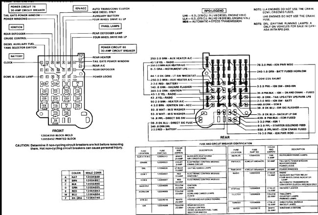

Where is the fuse box
1990 GMC SUBURBAN
123,678 MILES • V8 • 4WD • AUTOMATIC
S.COLEMAN
For the radio and interior lights.
Jan 19, 2018 at 12:30 PM
HARRY P
  • 2,292 POSTS
Surprisingly, ALLData does not say exactly where it is. I found this description on Google though: "drivers side foot well against the firewall. Basically behind the bottom lip of the dashboard. Right behind the hand brake pedal." Hopefully that is the right spot. I did manage to get the layout from ALLData though. It is attached below.
