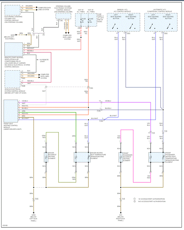

Where is the fuse to fix my drivers side heated seat located?
2013 VOLKSWAGEN PASSAT
44,400 MILES • 2.5L • 6 CYL • TURBO • 2WD • AUTOMATIC
STEFEN911
My drivers side seat and my passenger seat isn’t heating up.
Jan 31, 2021 at 6:53 AM
  • 110,244 POSTS

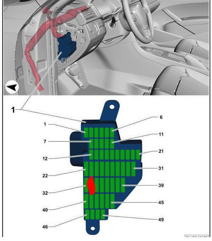

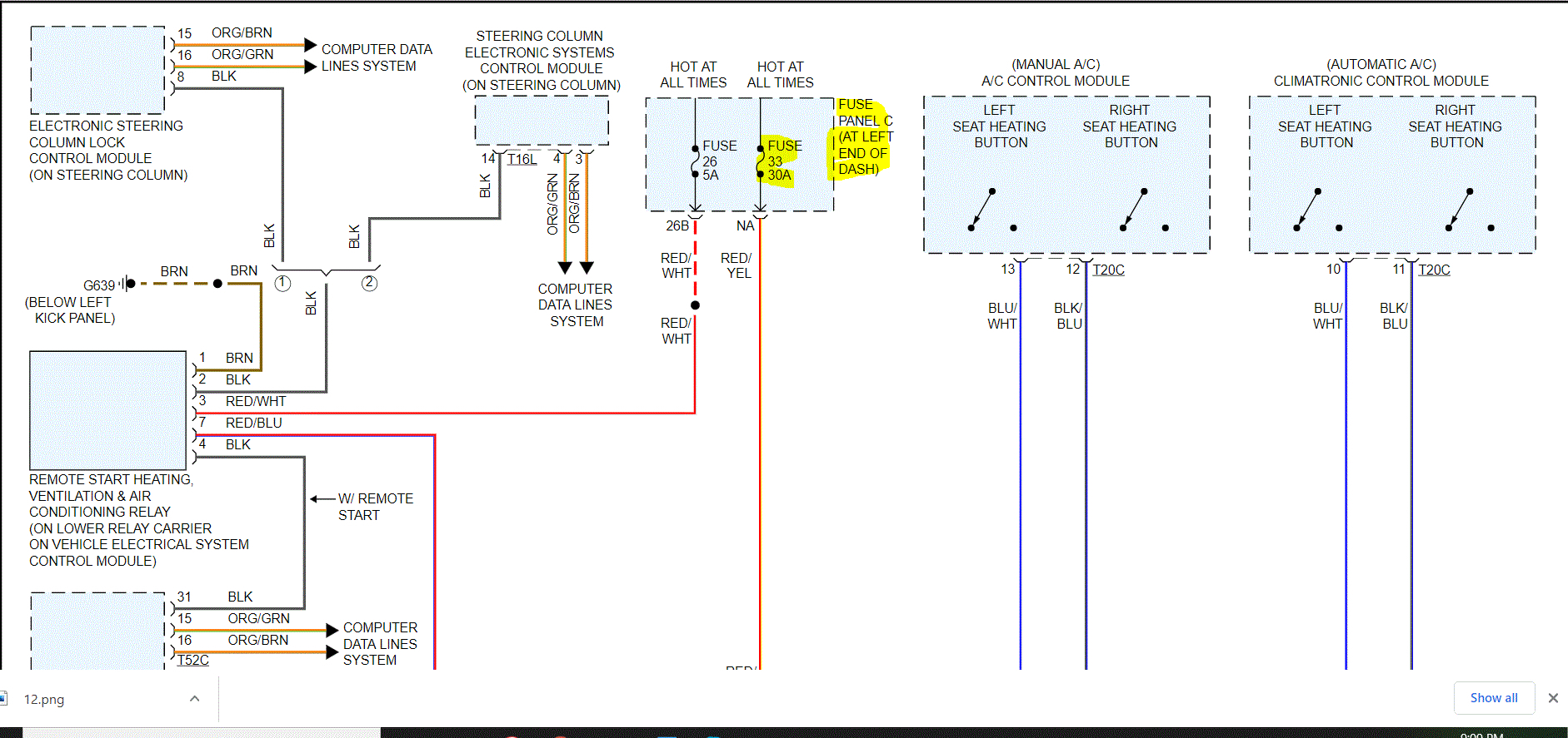

I attached a few pics below. The first is a portion from the wiring schematic. I highlighted the fuse. The second pic is the entire wiring schematic for your reference. In pic 3, I highlighted the fuse to check. In addition to checking the fuse, make sure there is power to and from it. Here is a link you may find helpful:
