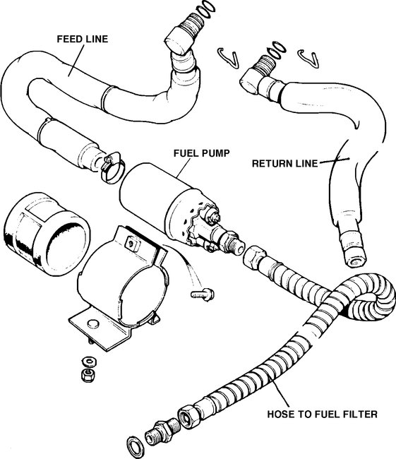

No fuel to motor.
Jul 17, 2019 at 6:41 PM
  • 110,194 POSTS
Welcome to 2CarPros.
Pump located under vehicle near right rear tire. I attached a view of the pump to help you identify it.
Here are the directions for replacement. The attached picture correlates with the directions.
_________________
Removal and Installation
Vehicle Powertrain Management Fuel Delivery and Air Induction Fuel Pump Service and Repair Procedures Removal and Installation
CAUTION:Observe all fire hazard precautions detailed in FUEL SYSTEMS / SERVICE PRECAUTIONS, when working on open fuel systems.
Fuel system MUST be depressurized before disconnecting any fueling component.
Fuel Pump And Hoses
Pic 1
1. Depressurize fuel system.
2. Disconnect battery ground cable.
3. Lift vehicle and remove right rear wheel.
4. Remove straps securing fuel pump feed hose to axle carrier.
5. Clamp fuel feed hose.
6. Disconnect fuel feed hose from pump. Fit protective plugs to pump and hose.
7. Through wheel arch, disconnect fuel pipe union nut from fuel pump and move pipe aside. Fit protective plugs to pump and hose.
8. Remove nuts from fuel pump mounting at axle carrier.
9. Disconnect pump electrical wiring. Note position of wires.
10. Remove fuel pump.
11. Remove mounting clamp and mounting rubber from pump.
12. Remove non-return valve from pump.
13. Reverse steps to refit pump.
14. Check for leaks.

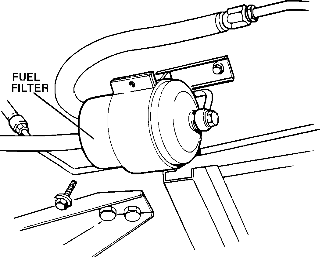

You may want to consider the filter, too. The fuel filter is located under car near left rear tire. See Pic 2

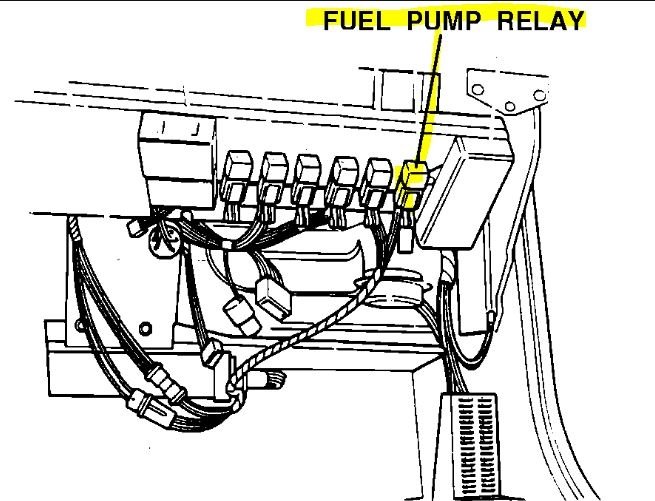

Before you just replace the pump, make sure there is power to it. If you look at pic 3, it shows the pump relay. You should check that as well.
Jul 17, 2019 at 7:51 PM
CHRISLIC
My car does not have what that picture shows about the fuel pump relay is. so where could it be?
Jul 17, 2019 at 9:08 PM
  • 110,194 POSTS
Welcome back:
I am so sorry. I forgot to add the picture. See the picture attached.
Jul 17, 2019 at 9:41 PM
CHRISLIC
That behind the glove box?
Jul 18, 2019 at 8:32 AM
  • 110,194 POSTS
To the best of my knowledge.
