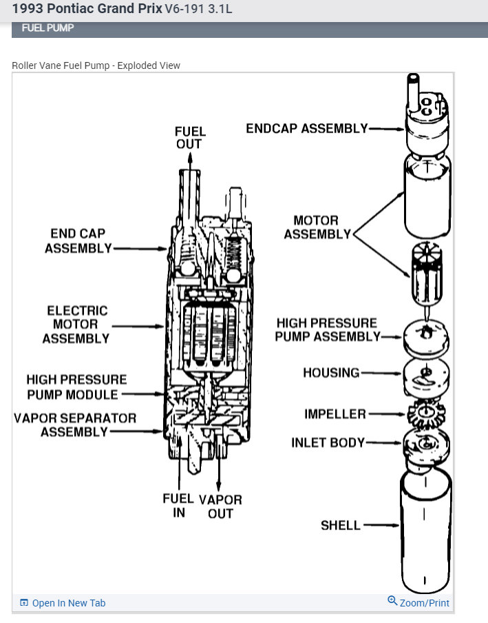

I cannot locate the fuel pump.
Sep 13, 2016 at 3:26 PM
SQM
  • 6,383 POSTS

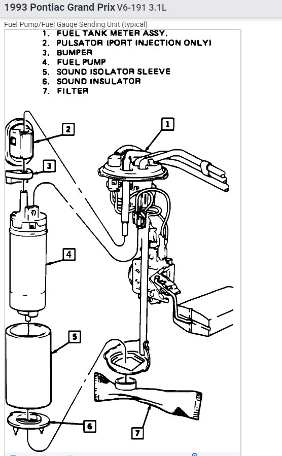

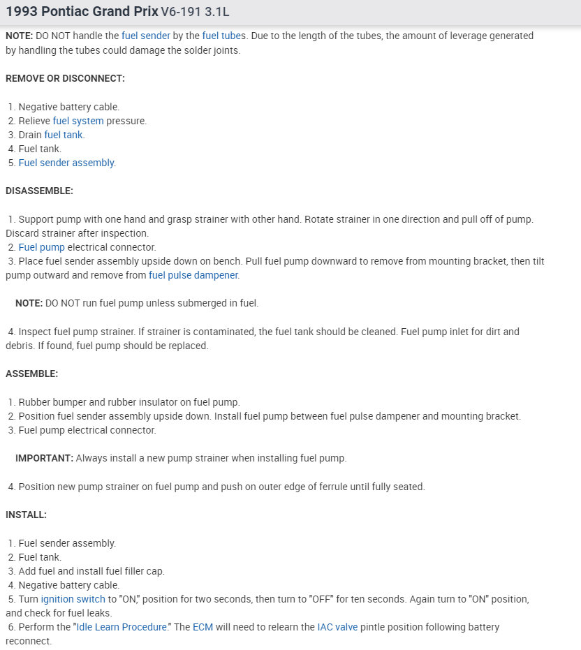

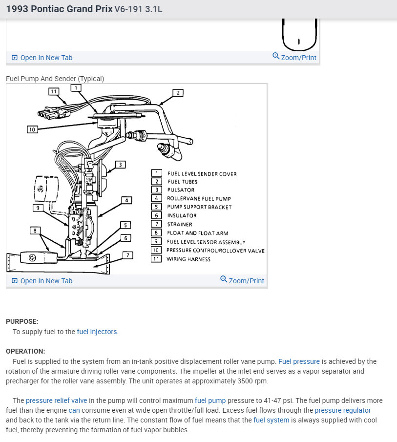

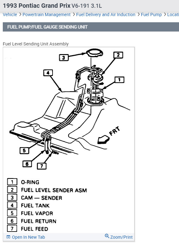

The fuel pump is located inside the fuel tank.
In order to replace the pump, the fuel tank needs to be removed from the vehicle.
Here is a helpful article:
https://www.2carpros.com/articles/how-to-replace-an-electric-fuel-pump
I have attached replacement instructions for your reference.
