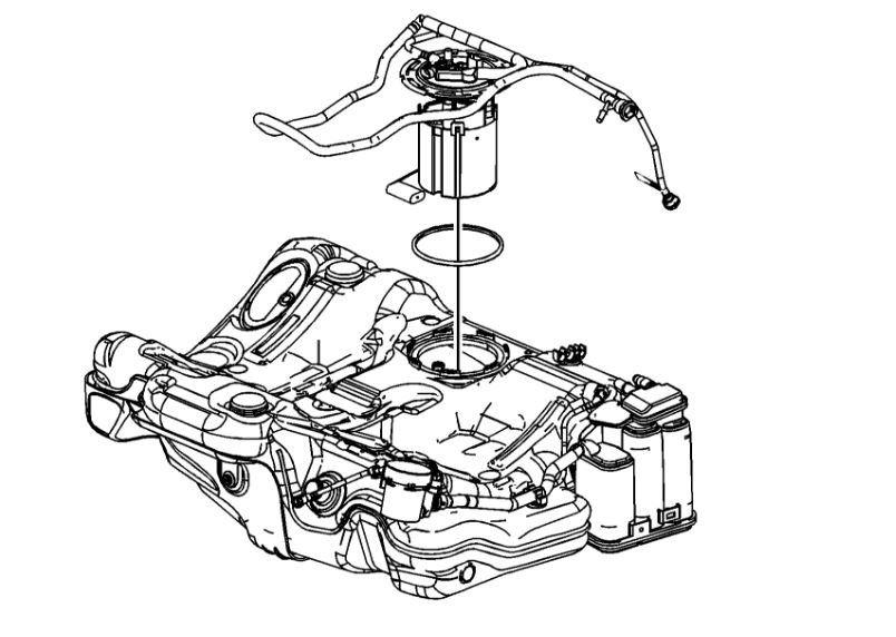

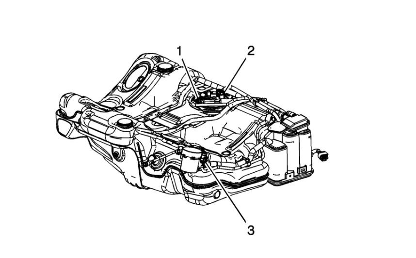

My car will start and drive for a while then it cuts off after ten minutes or less.
Aug 13, 2018 at 1:15 AM
Good morning.
It is inside the fuel tank. The fuel tank must be dropped out to gain access the pump.
1. Relieve the fuel system pressure. Refer to Fuel Pressure Relief. See: Fuel Pressure Release > Procedures > Fuel Pressure Relief
2. Drain the fuel tank. Refer to Fuel Tank Draining.
3. Raise and support the vehicle. Refer to Vehicle Lifting.
4. Remove the body wiring harness electrical connector clip (1) from the underbody.
5. Disconnect the body wiring harness electrical connector (2) from the fuel tank fuel pump module wiring harness electrical connector.
